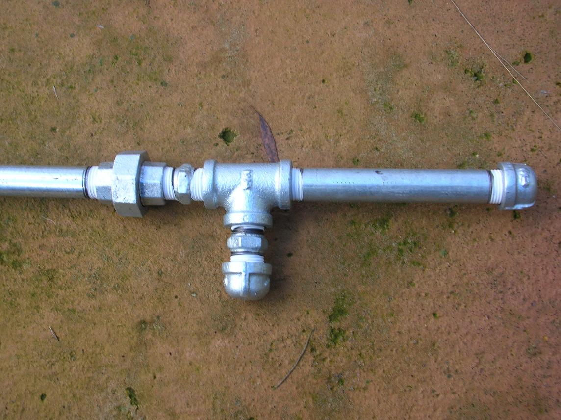

Yesterday I designed a hybrid (in my head). I ended up in a hardware
store 4 1/2 hours ago. This is the result.
It still needs the spark gap, cable gland & one way valve.
I want to install a 1/4 inch NPT shrader, instead of binary adhesives.
And the specs
15mm bore (at the moment)
45cm barrel
45cc chamber
20mm burst disc
1-5X mix
That's about the sum of it, so let me know if I've missed anything
or if you want to know something.
$37AUD Hybrid
Does the barrel have a seam through it? How do you plan on installing the ignition?
Ah, a couple of firings and the seam will probably wear smooth anyway
good luck with making it happen. Is it going to be hand-held or mounted?
Handheld, the damn barrel was the most expensive part, I couldn't get the 7.5mm 100cm aluminium tube that I wanted, couldn't find the 12mm
150cm copper either.

you could use a old 12g or 20g shot gun barrel weld it to a nut . that way you could have a really smooth inside & use shotgun wads as your sabot . + then use solid slugs or shot . i have been told 20g is the same as .577 - 58 cal & paint balls .

I probably would use copper pipe for the barrel, as this handy guide shows, it can take hybrid pressures.
How do you intend to meter your fuel and pressurize the cannon?
From the copper tube handbook in the link
All I can say is that there is probably less than $10 of material in any of the hybrids I've built so farlinuxexorcist wrote:Really JSR? nothing to say on that?
