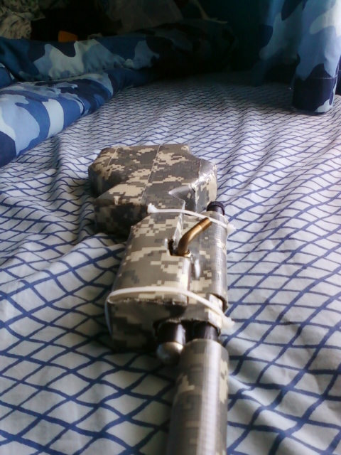

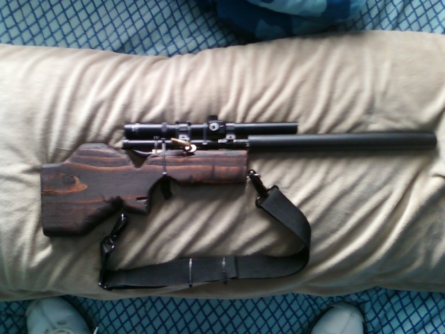

Remember my old thread? well this gun is the new version of it. I went to home depot and got a 2x6(not sure what type of wood it is), then i printed out an outline of a drawing of the stock on MS Paint, then i got to work to make it happen. After about 3-4 hours, this is the result. I stained it with some miniwax red mohogany #225 stain. It utilizes an empty co2 cartridge as the air chamber, shraeder valve to fill it, ball valve as the firing valve(it will soon be a QEV), and right now i run it on 125 psi(highest my bike pump and air tank can go to). I will also get a nice shock pump for it soon, to unleash its full potential. It is an all metal construction. Any questions just ask!

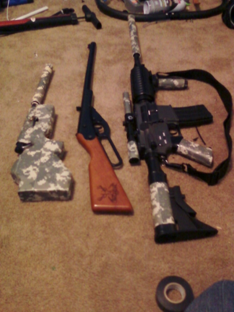

New pics with the slightly sanded finish and sling

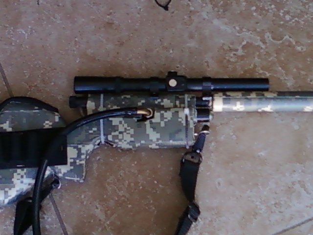

NEW PICS PAGE 4!!!

I will get more pics up later(btw that zip tie on the gun in the pic was only there till the glue dried, its gone now)

Seriously tone it down with the double posts, the mods kill for that. Anyway, the stock seems very... ummm... don't know the word... compacted? Squished? Is that the way you intended or simple a trick of the image? Anyway I still think its a sick gun, nice work, expect performace gains of 10x once you get that shocky and the QEV

I like the stocks compact look, and gun freak you kept bumping up and double posting in your supernova thread, by the way what tools did you use to cut out the stock

Thanks guys! and double posting is a VERY bad habit i have lol. ive done it on this site for years haha. but it is supposed to be compact like that. since the guns internals/barrel are pretty small, i also wanted the stock to be like that. the stock is 1 foot in legnth, as well as the barrel. and to cut out the stock i used a Power saw, hack saw, rip saw, Rasps, files, and a bit of sandpaper, pretty basic tools. I cut out the rough shape with the powersaw, then moved on to cutting it out a little more with a ripsaw, then some of the bigger curves with the hacksaw, then for all the bends/curvs i used a rasp to carve them out, then filed it and sanded it, then just stained it.
