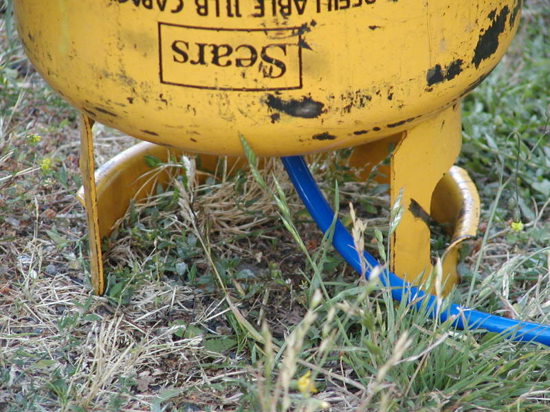

Use a pump. There is little air exchange through a small hole so it would take forever to dry. Even purging a propane tank with a 1 inch hole requires using a pump. Here is a photo of a propane tank being purged with air prior to using an electric drill on it. I let it purge for most of a day before drilling. A vapor of only 4.2% is very explosive. Use the same procedure to dry paint. Vent until it no longer smells like wet paint.
