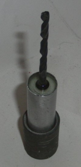

Experience is a harsh mistress. I started using epoxy for spudding purposes 12 years ago ( :shock: ) and I remember the frustration in beginning when frequently a carefully made coaxial is lost forever as epoxy from the rear endcap leaks into the pilot area :roll: but you learn your lessons pretty quickly.
This is how the current one is curing, I'm using a 4.5mm drill bit wiped with grease as a mandrel.

Cured beautifully :) it pops very consistently at 50 psi, which means it's only good for 4x, which means it's useless, but yay o-rings!
The problem in this case is that although the o-ring has a 3mm I/D, since I cast it with a 4.5mm mandrel through it the ring is held open by the epoxy so it lowers the pop-off pressure considerably.
I'm inspired enough to make another one though, watch this space :)

It does seem like a much better design, as unlike your old way which had a BB being subject to a consistant resistance, this way the resistance increases the further the BB is pushed into the seal. Given some fine tuning I think this design is promising.
I do wonder for how many shots the seal will last, however.
Been thanked: 350 times
Insomniac wrote:I do wonder for how many shots the seal will last, however.
I'm sure it would wear out eventually, but I'm hoping you could easily remove the old seal from the groove cast into the epoxy and pop a new one in :)

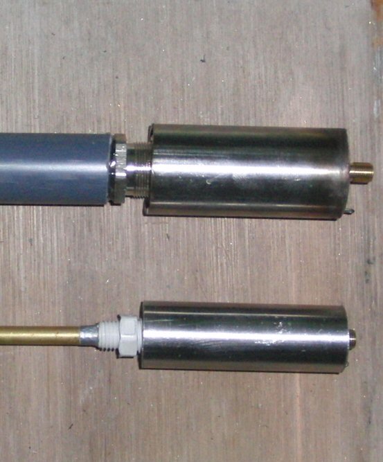

Following the success of this project, I've decided to ramp things up a little :D still a "mini" by this forum's standards but with a 3/4" barrel and a wider chamber made of 2mm wall thickness 316 stainless, with the threaded fitting from an ATEX electrical connector.
As the weather's gotten colder it will be given a good baking today, testing later :) here it is compared to the subject of this thread for scale:
Who knows, maybe by christmas you'll have a hybrid that's bigger than my hybrid's fueling meter :D
Kidding aside, I'm glag to see you've ramped things up a little. Bigger may not always be better, but it sure is more fun. Do you literally bake your epoxy creations by the way? Just wondering what your method was and if it's better than conventional methods of leaving it in the garage over night :wink:
MrCrowley wrote:Who knows, maybe by christmas you'll have a hybrid that's bigger than my hybrid's fueling meter :D
Who knows, outback boy :P :D
Most epoxies cure faster when at higher temperatures, in Summer I can leave stuff out in the sun and it will be done in 12 hours whereas in Winter sometimes it doesn't cure after 24 hours. At this time of year I find chucking curing parts into one of the lab ovens at 50-60°C means that they're ready for testing by the time I get home :)
