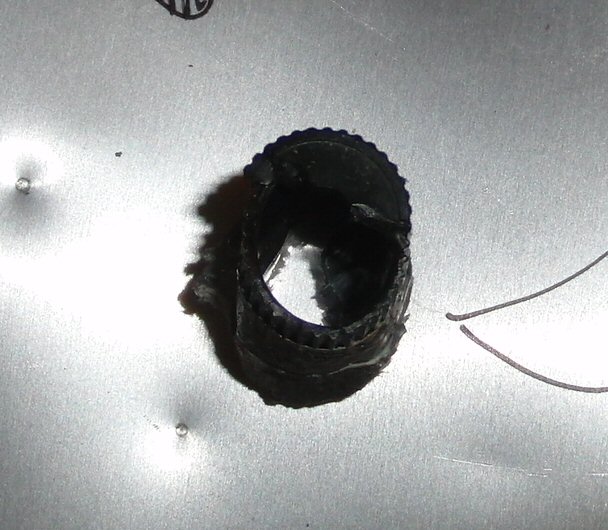

Tried a shotgun round using a plastic marker cap as a sabot, guess what happened :roll:
As you can see the sabot fragments made it to the target first, followed by the lead shot that was obvious not very energetic, having only the gas blast to push it along...
Here's what's left of the sabot:

ha ha ha what about making a cup out of layered aluminium foil, not sure if it would work but i think its worth a try

I would think that a plastic cup should be strong enough to survive the blast :roll:

I see a good application for a solid steel sabot...

saefroch wrote:I see a good application for a solid steel sabot...
Actually, a 12 gauge shotgun sabot would be perfect, fits nicely in the barrel and can take the 12-15,000 psi the firearm generates - I just don't have any around at the moment.
