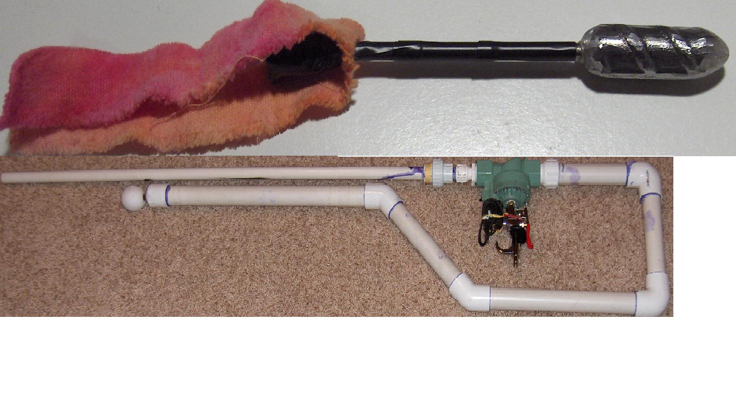

As for simulating rounds, I can just use solidworks to get a pretty accurate prediction on mass. My heaviest current round is 25g, consisting of a nail stuck into a piece of rebar and an attached tail for stability and better sealing in the barrel. GGDT predicts 90.3 ft*lbs and 325 ft/s form this which is ok I guess. I currently use lighter nail darts since my parents think I'll blow myself up if I take my launcher up past 40psi :x
That's one of the reasons I'm building this out of copper. Anyways here are some pictures.
The brackets conecting the barrel to the chamber broke and I haven't gotten around to making new ones. The union is there to act as a breach, with the brackets in the barrel just slides forward and then back. Also the primer job is horid, but o well it was my first.
