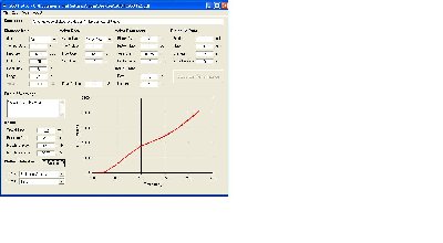

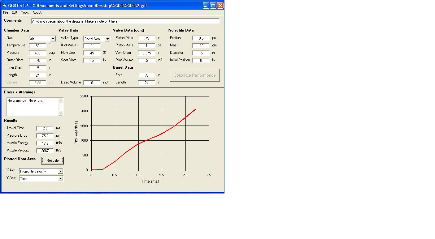

Yeah "canon" was definitely the wrong term to use haha. I was initially planing on something with a 1/4in barrel however I visited my local home depot a few days ago and found out that they only have 1/4 copper coiled up for refrigerator use. This lead me to scale it up a bit and I've decided that 1/2in copper will be the barrel and 3/4in copper will be the chamber, both 2ft in length since thats what they sell it cut at. The pilot valve will be a 3/8in ball valve. GGDT gives a chamber volume of 5.89in^3 which might be a bit much. I'll probably end up filling fart of it with something to decrease it a little if pumping it is too much of a hassle. GGDT also says that an airsoft bb would go 2067 ft/s which is awesome cause I've always wanted to break the sound barrier. Don't know if that would actually happen though.

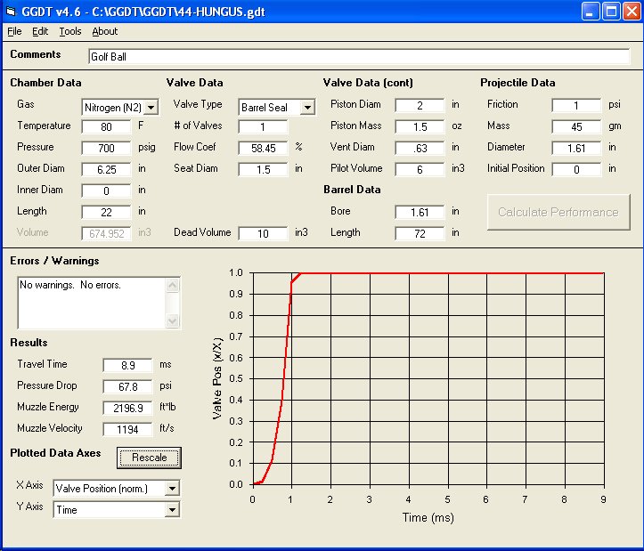

Well first off, GGDT becomes very optimistic near and exceeding supersonic muzzle velocities. Can you take a screenshot of the data you put into GGDT? It seems rather optimistic to get a supersonic muzzle velocity at 400psi. Have a look at this thread I posted on the subject when I got a similar prediction.

Thats interesting. Too bad I don't have access to equipment that can measure speeds like that. I guess I could just use a projectile that weighs .575g and see if it produces a sonic boom. According to GGDT it should travel at 1127 ft/s, 1ft/s higher than the speed of sound if I'm not mistaken.
I am a little disappointed at how little muzzle energy I'm getting, especially compared to your beast.
The low mass of your projectile is the reason for the incredibly optimistic muzzle velocity. Keep in mind that an airsoft BB is only about 1/4" in diameter. Scaling up the airsoft BB to a .5" diameter gives a mass of about .96 grams. Try to use a very accurate estimate for the mass of your projectile, that's a very significant factor in muzzle velocity. If anything like a sonic boom occurs, you probably won't be able to hear it over the muzzle blast, but supersonic is still amazing.
The low muzzle energy is probably due to the low mass of the projectile. Throw in a greater mass value and you should see a significant increase in muzzle energy.

Yeah i realize this and was thinking of having a light sabot or something like that that wouldn't add too much weight.
I've messed around with different masses and even at 1kg the muzzle energy is only 100.1 ft*lbs. A tenth of that, 100g still produces 98 ft*lbs so i think anything that is more massive than that is just a waste since the fps drops horribly low. At 100g it's only 169 fps
This might be a stupid question, but should i be more concerned with muzzle energy or muzzle velocity? It seems to me that with my current set up I can't really have a decent amount of both. Now I'm not really familiar with ft*lbs and how much is a lot, but I think even 100 is low, especially when compared to velocity3x's cannon.
Most any sabot will add significant mass to an airsoft BB, unless it's something like an aerogel.
There is little use trying to compare your cannon to the golf ball cannon velocity3x posted data for, because it has a much larger bore diameter (more force on the projectile) and is running higher pressure.
Instead of plugging in random numbers into GGDT for projectile masses, try using it to simulate different projectiles you may plan on shooting. Think up a design, make up some reasonable dimensions, and look up density values to come up with an appropriate mass.
You shouldn't be concerned overmuch with either muzzle velocity or muzzle energy, but try to find some sort of balance. If you were to plug in the data for my Trident into GGDT, you'll find that there is a very significant increase in muzzle energy from a small and achievable mass increase. This suggests I should be launching something heavier for better overall performance.
Ft*lbs is a unit of energy, which comes from the equation for kinetic energy = 1/2*mass*velocity^2. It may be useful to compare your muzzle energy to that of conventional firearms to get an idea of what kind of "power" you'd generate.

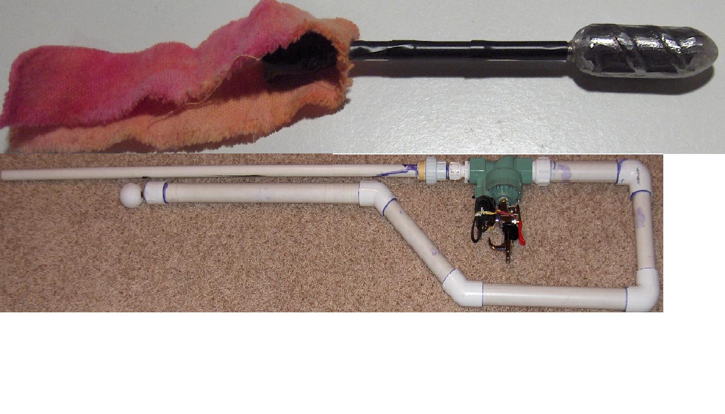

As for simulating rounds, I can just use solidworks to get a pretty accurate prediction on mass. My heaviest current round is 25g, consisting of a nail stuck into a piece of rebar and an attached tail for stability and better sealing in the barrel. GGDT predicts 90.3 ft*lbs and 325 ft/s form this which is ok I guess. I currently use lighter nail darts since my parents think I'll blow myself up if I take my launcher up past 40psi
That's one of the reasons I'm building this out of copper. Anyways here are some pictures.
