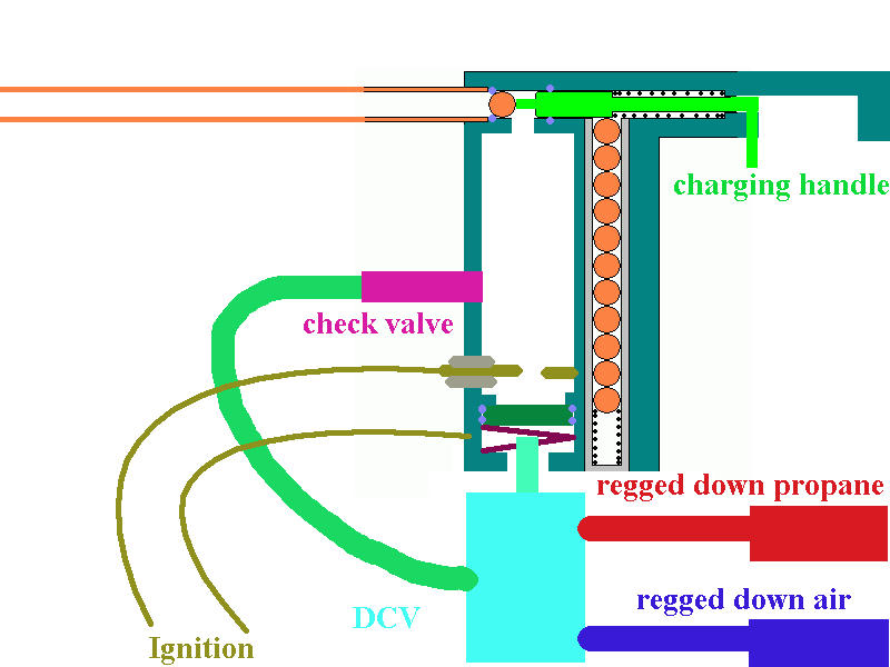

I've kicked around something along these lines:

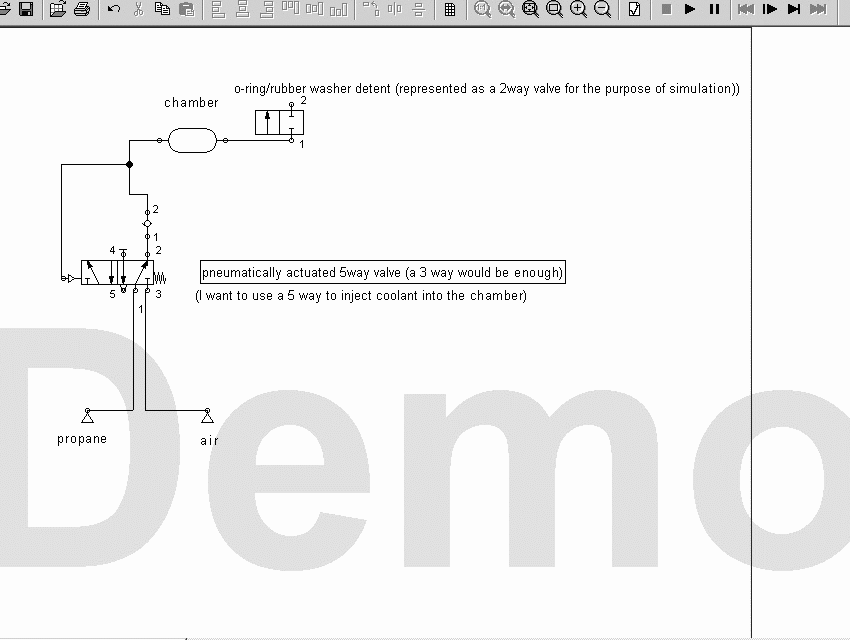

And then there is this beast:

LOL
nice diagrams I almost jizzed myself
it looks a lot like the design I want to use for the semiauto hybrid
Nice... you could use one 3 way valve to replace the two 2 way valves

@ Poland - I needed a way to actuate a valve using air pressure. Most valves are air piloted, not actuated. The Clippard components allowed me to do this.
All this got dumped for the insanely simple current setup:
Hell, I don't even have a gauge on it anymore.
