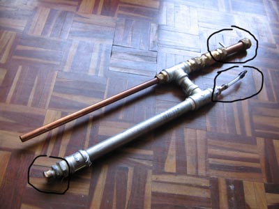

I have new udates to post. First I have add a fill valve to the chamber side, second I have made a bolt hammer system to slam into the one way valve and open the diphram. I still have to make the trigger for the bolt but am not sure how, ideas are appreciated.
Now for the images:
Bolt, chamber side fill and small pressure gauge.
The bolt was fairly easy to make, the actual bolt itself is pvc.
Note the small hole where the trigger will lock the bolt in place.

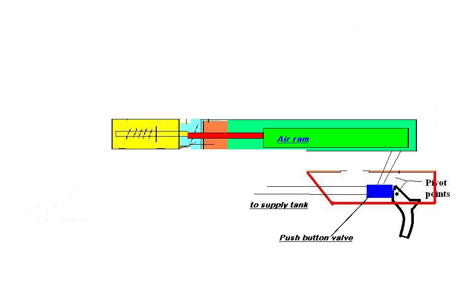

On the last pic, that hole is how you are going to lock the bolt back? And then have a triggering thing? Do you all ready have a spring in the back of the bolt? I dont know if this would work to good but you could get a double acting air ram and use it for the triggering. http://www.surpluscenter.com/item.asp?U ... atname=air
And what you could do is plumb in the ram in your air tank and then have a pushbutton valves in the air lines so that it would retract itself. Threre is a pic. Sorry if I am not talking right i have been up for all most 20 hours lol

This design of bolt that I built is a bit too flimsy, do you have any ideas similar to this one that will be very tough? Your design is a bit too complex(yes it is simple) but I need to make something simple and affective.

I think he ment how do you pay for it. Back to the ram idea(there are $5) You could have it were the bolt is. And then have it triggered with a 1/2 QEV if they make them that small.
That ram has 300lbs of push! and the max air limit is 250PSI. I wouls use that to repolace the bolt.
On page 406 of McMaster there is the valves, the one on top, norm closed and not the mushroom style. That is what will trigger the ram.

I would like to make it as simple as possible. But at the same time I want it to be fancy. The pneumatic ram idea is good. I will experiment with exhaust valves after I get my 20 oz paintball tank and regulator set up. I don't like the one way valve too much. It is a 1/2 inch so I am sure I can replace it.
