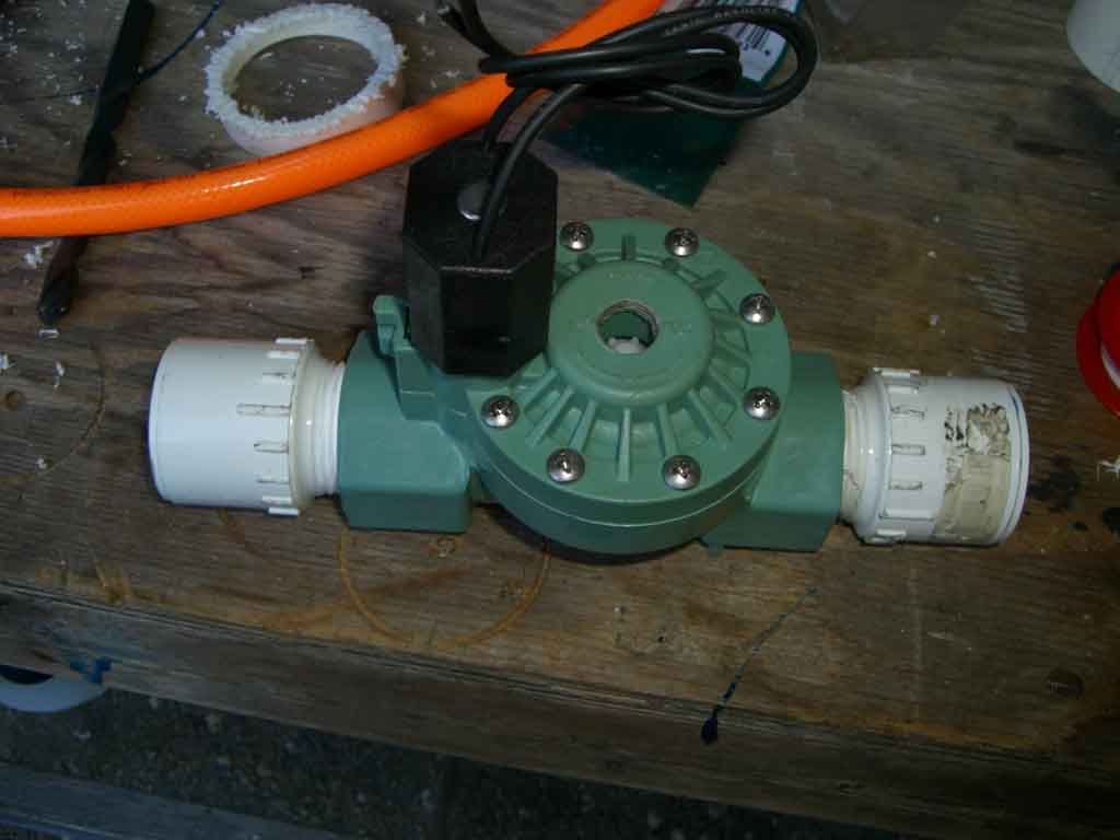

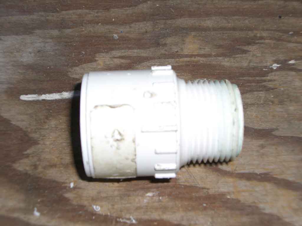

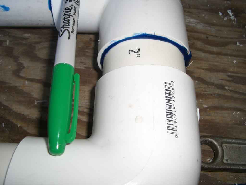

Theae are instructions to build a paintball cannon
Materials:
1x 36" 2 inch PVC sch 40
1x 36" long 3/4" Sch 80 Sprinkler riser
1x 2" cap sch 40
1x 2" coupling sch 40
1x 2" x 3/4" bushing sch 40
2x 2" elbows sch 40
1x short length of sch 40 3/4"
1x 3/4" male thread adapter
2x 1" male adapter
2x 1"slip x 3/4" thread bushing
1x Mod sprinkler valve (see other how to)
2x Teflon tape
1x common since
Tools (specilty)
1/4"NPT tap
1/2"NPT tap
PVC glue and primer
filling system coming later
START AT THE BOTTON OF THE POST

yeah thats what it looks like. You shoul use 3/4 cpvc for the barrel though because its the best fit.
SOO CUTE!! OMG!! I COULD JUST LICK YOU!!Insomniac wrote:Hey why am I a goose???? Why not somthing a little more awe inspireing, like an eagle or something? LOL
nice job with the basic over under design. the only flaw i see is that it would take time to reload this sucker. an added breech would be really cool.
