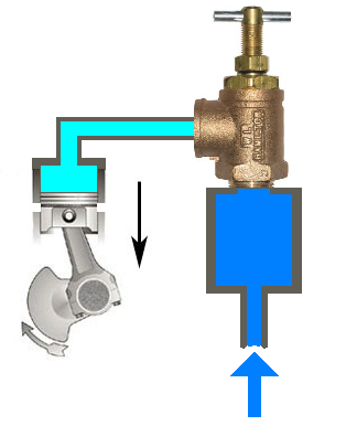

Gunfreak, unless you're using high pressure, I would suggest a much larger piston head.
A pressure relief valve could be used to drive the piston...

How would the air supply cut off on when the piston is on the upstroke?
- POLAND_SPUD
- Posts: 5402
the piston exposes the vents -> pressure drops -> pop-off valve closes
I don't like that design - too many variables that have to be tweaked

How about this, the pop-off piston is the actual piston. The piston is loose in the cylinder in order to stop it hanging.POLAND_SPUD wrote:I don't like that design - too many variables that have to be tweaked
- popoffengine2.PNG (6.99 KiB) Viewed 2692 times
Just a thought... would it be possible to do away entirely with a flywheel if you used a lot of pistons, with their stroke positions each seperated by just a little bit? For example, if you have 10 pistons, #2 would be 10% (by time) into its stroke when #1 is just beginning its respective stroke...
