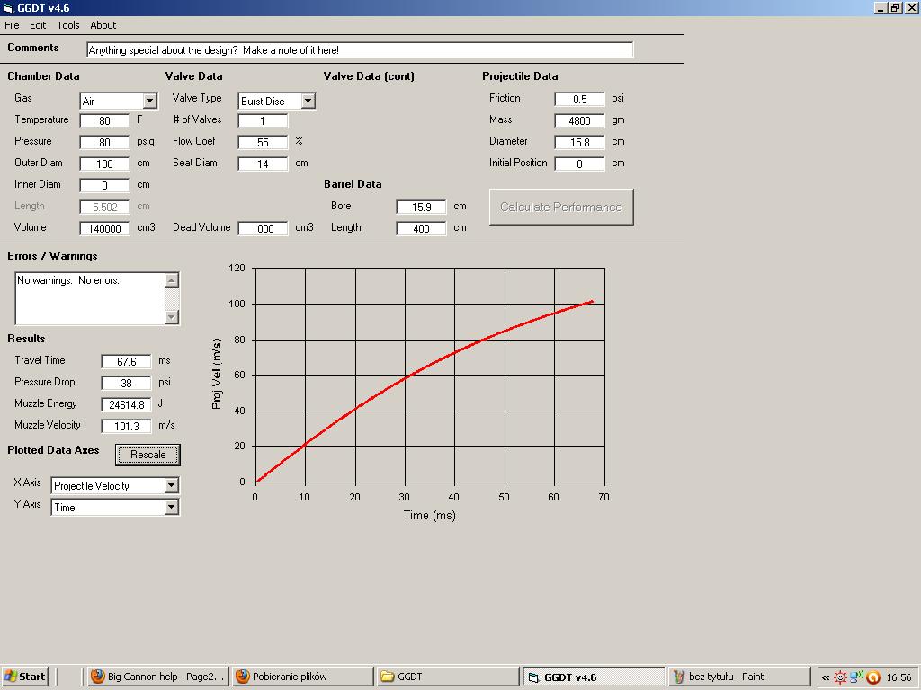

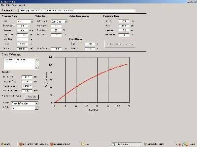

I used specs you mentioned to model it in GGDT
I assumed:
a 14cm burst disk
1L deadspace
extra 300 g for a sabot (barrel ID is 159mm so you need a sabot)
and the pressure -> 80 psi (100psi gives you 112m/s of MV)
I assumed:
a 14cm burst disk
1L deadspace

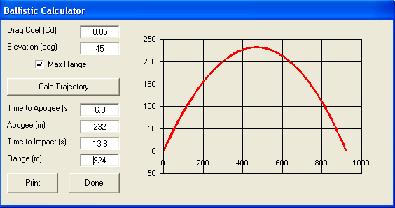

According to GGDT's external ballistics calculator, with a generous drag co-efficient of 0.05, you'll get less than a kilometer at 100 m/s - I assume this is for test purposes and the actual intended velocity is much higher.POLAND_SPUD wrote:I doubt you could achieve more than 15 km. Please excuse me as you probably know better what you're doing, but that's just what I think.

I think it's just for testing of the terminal phase of flight (ie. how well the UAV can transition into normal flight)you'll get less than a kilometer at 100 m/s

The simulation indicates that you can get that over 100m/s with the setup you described at around 80-90psi
Can your tank handle that much ??

Spot on, we just want to test out the parachute/deployment mechanisms first. We are firing up at 70 degrees to get enough height to give it time to deploy out.

I think so, we are using LPG tanks that were previously certified for higher then 120. Hopefully we can get it re-certified after I've taken to it with a welder.The simulation indicates that you can get that over 100m/s with the setup you described at around 80-90psi
