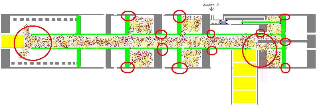

nobody here to help me and to discuss my diagram?
i see the minigun but it is another concept...
forget the building issue and forget the fuel meter!
let see what the cylinders do...
please help me to figure it out please

auto combustion. wil this work?

the right part of the diagram works pretty good also the reloading.
i had test it but with syringe fueling and in a getto assembling
and the repeating process will done through the cylinder?
have it the ability to recock itself?.
by
edit
my big fear are the many leaks they come up in the process of going forward.
or make with o-rings but this is maybe to much friction......
by
edit

With floating o-rings, the friction may not be much, but a combustion is weak in a airsoft scale, and in your design a high volume of expanding gas are wasted to the recycling process. How are you going to make sure there are enough fresh air in the chamber to have a combustion reaction? Assuming you want a decent rpm.

I see no use in further discussion or improvements of this design... It's way too impractical.

I hate agree with GF but I don't see this happening without some sort of external mechanism cycling the action, the forces and inertia involved and the brief interval in which the various chambers will be pressurised is insufficient in my view to make it work.

can you explain it please .. it is difficult to understand for me .. my english.....jackssmirkingrevenge wrote:........I don't see this happening without some sort of external mechanism cycling the action, the forces and inertia involved and the brief interval in which the various chambers will be pressurised is insufficient in my view to make it work.
ok my goal is a full-auto combustion without any other power than the combustion out of the fuel. no bulky regulators or dcv or something other stress ) and please no torch thingy fuel.
what option's i have?
because of the fast rate of fire i have in my mind (say 3 per second) i think a piston that displace the combustion gas and suck new fuel in is the right way (like a car motor)
but how to driven it??
any suggestion?
without the word's minigun, pneumatic or cartridge
by
You realise this is something that has never been built, so it is certainly an ambitious project.jean wrote:ok my goal is a full-auto combustion without any other power than the combustion out of the fuel. no bulky regulators or dcv or something other stress ) and please no torch thingy fuel.
In your design, you want the barrel to move forward while there is still pressure in the chamber, the forces will cancel eachother out and it will stay still.
Rather than using a "moving wall" suppressor to cycle the action (works great in the FX Monsoon at 1500-3000 psi, but a 100 psi combustion, hmmm...) I think you should try and use the substantial recoil forces as the agent by which to vent the chamber and refuel.
I also think you should separate the action of reloading the projectile from refuelling. There are plenty of systems (such as theblow forward bolt) that can use the propelling gas to do that separately.

You do know that a car engine has valves in it and a sort of regulator (carbourator)?ok my goal is a full-auto combustion without any other power than the combustion out of the fuel. no bulky regulators or dcv or something other stress ) and please no torch thingy fuel.
You're saying I want to build a wheel that's rectangular and doesn't move
Let just say I know what you mean but if you don't include off the shelf parts in your design you have to build them your self and include them in the design.... that makes things a lot more difficult
Says it all reallyPOLAND_SPUD wrote:You're saying I want to build a wheel that's rectangular and doesn't move

Yeah everything else aside, your absolute biggest problem and its one that will stop this auto combustion dead in its tracks) is venting the chambers. The way your diagram is laid out you have very little in the way of bringing fresh air in.
After we solve the problem of the oxidizer we need to deal with heat. Your going to generate ungodly amounts of heat.
Basically you have an overthought out shocker (paintball gun). If tippmann can design a pump action combustion marker but can't or won't build a semi-auto combustion it is probably for a good reason
