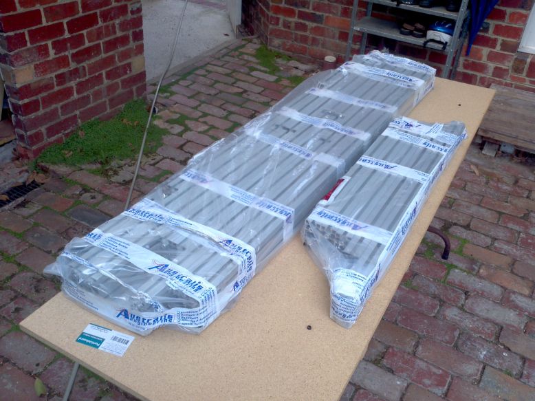

The build is progressing:
The aluminium engineer in Melbourne was a let down but I found a great crew in Sydney who can do exactly what I want for 1/3 Melbourne price. If you are in Oz and looking at this sort of home brew CNC check out Australis Engineering. They are making the whole frame in kit form and shipping it to me ready to assemble, should be here next week.

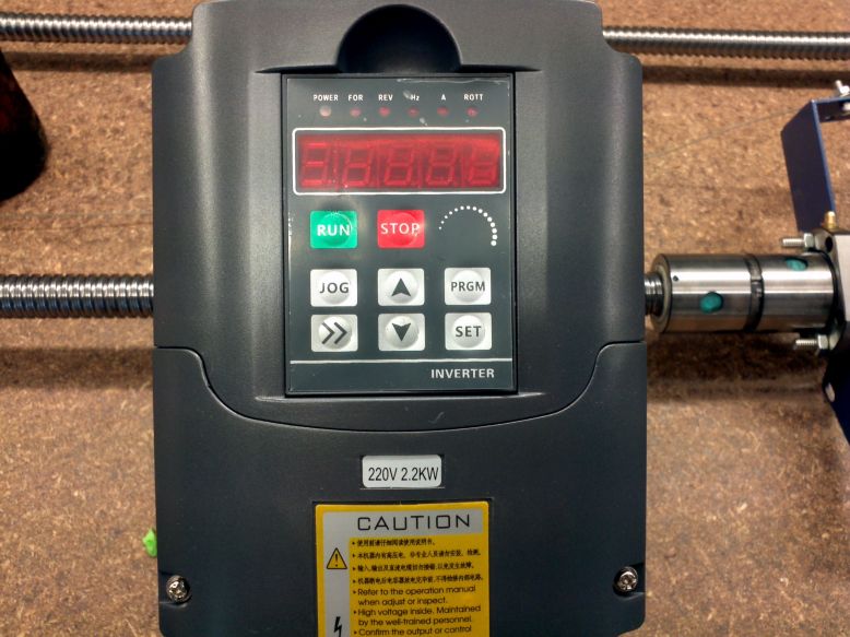

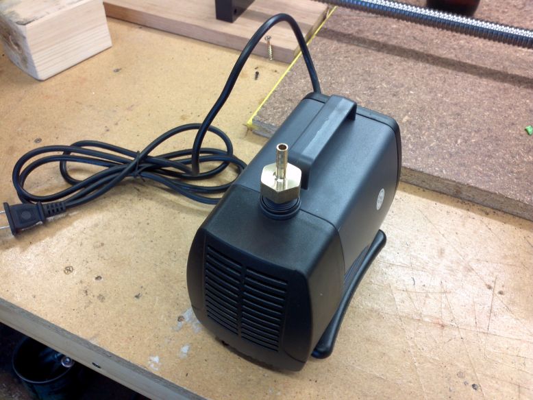

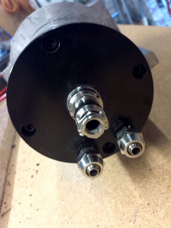

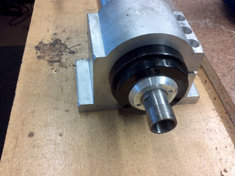

In the meantime eBay came through with the 3HP water cooled spindle, arrived at the office yesterday.
Pics below, my sparkie is coming over the weekend to test and tag before I power up.
Question:
Anyone have a source for short lengths of VFS motor cable, Belden preferred? All my local wholesalers want me to buy 100 metre rolls.

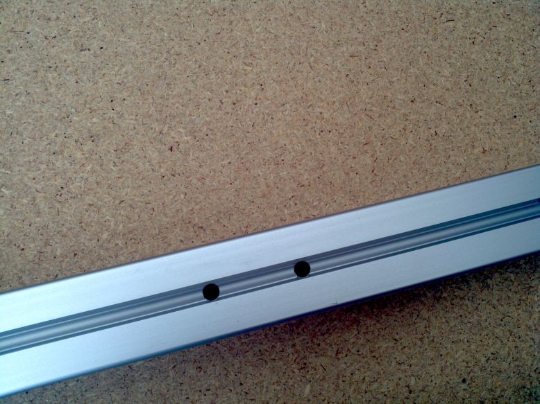

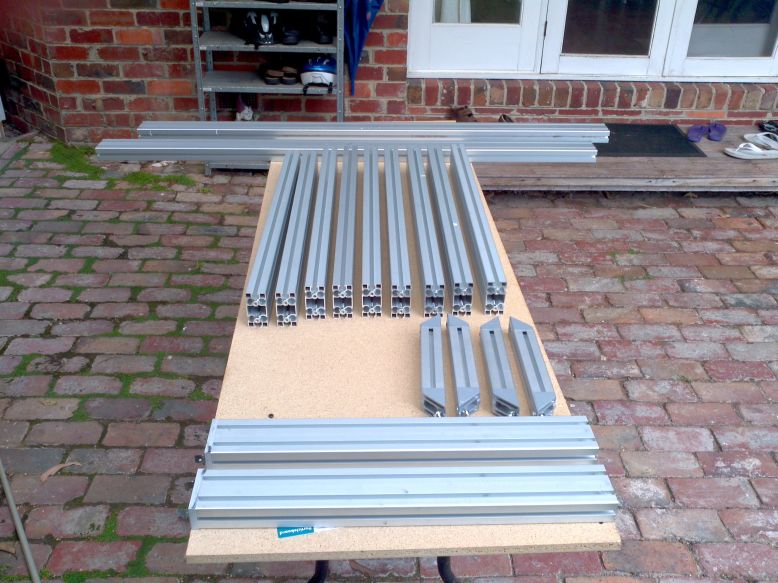

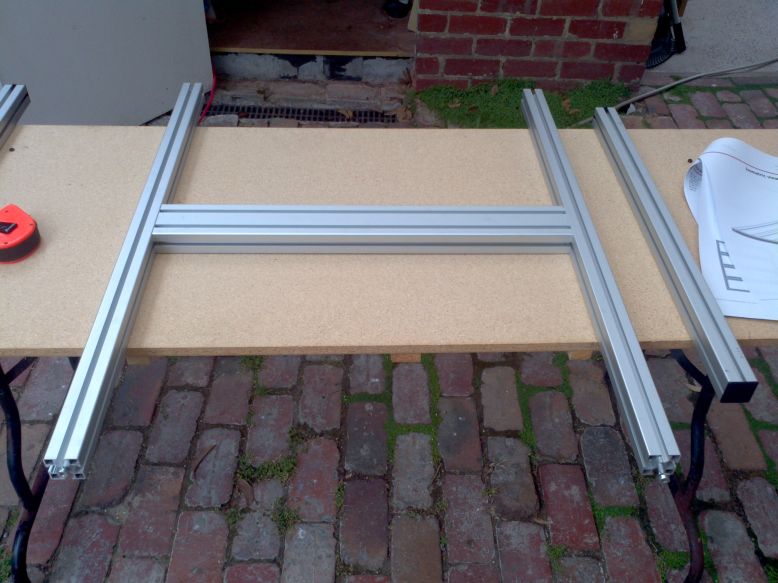

Herewith the first dry assemble of the frame.
This is only rough to ensure the fabricator sent all the right parts.
Looks OK so far, one minor quibble with the alignment holes at one end but overall very happy with what they did. Cost with freight from Sydney was just over $1k. That may sound high but remember this extrusion goes for over $200 per length and I got them to do all the drilling and tapping plus supply fixings.
Anyhow, off to the hardware store this morning to gather bits for making a proper table, then move onto the full assembly.

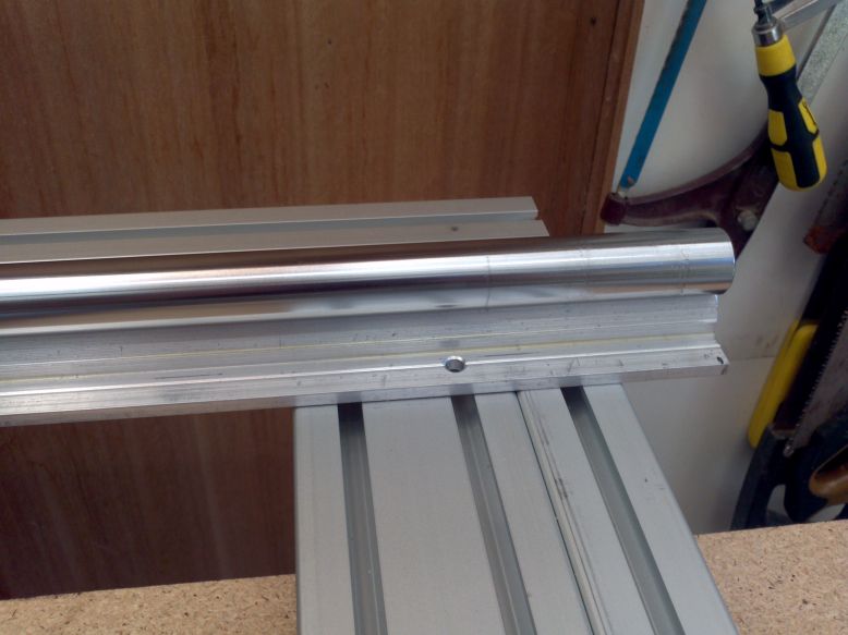

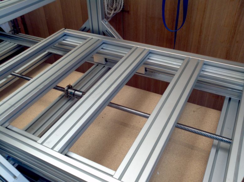

I made up the linear slide assemblies for the x-axis last night and this morning, pretty happy with them so far.
Everything is still a dry fit mock up for now, I intend to pretty much assemble the whole thing except for electronics to learn from my mistakes then tear it down and do an accurate final build.
