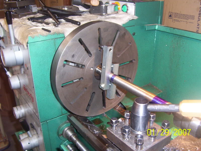

velocity3x wrote:A dead center is used in combination with a faceplate (instead of a jaw chuck) and lathe dogs
I'd like to see how your setting that up.

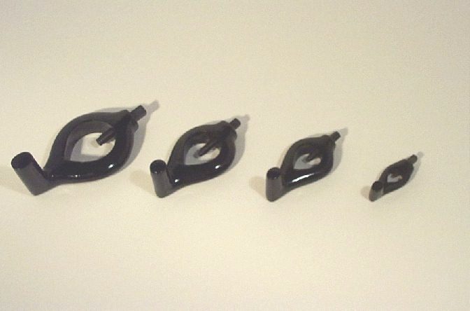

jrrdw wrote:I'd like to see how your setting that up.
These are pics I found in the net. The last pic shows the dead center in the spindle bore of the lathe and a live center on the tailstock. The lathe dog is homemade. This setup is used for turning between centers. Turning between centers is how you make a crankshaft from a chunk of billet.
