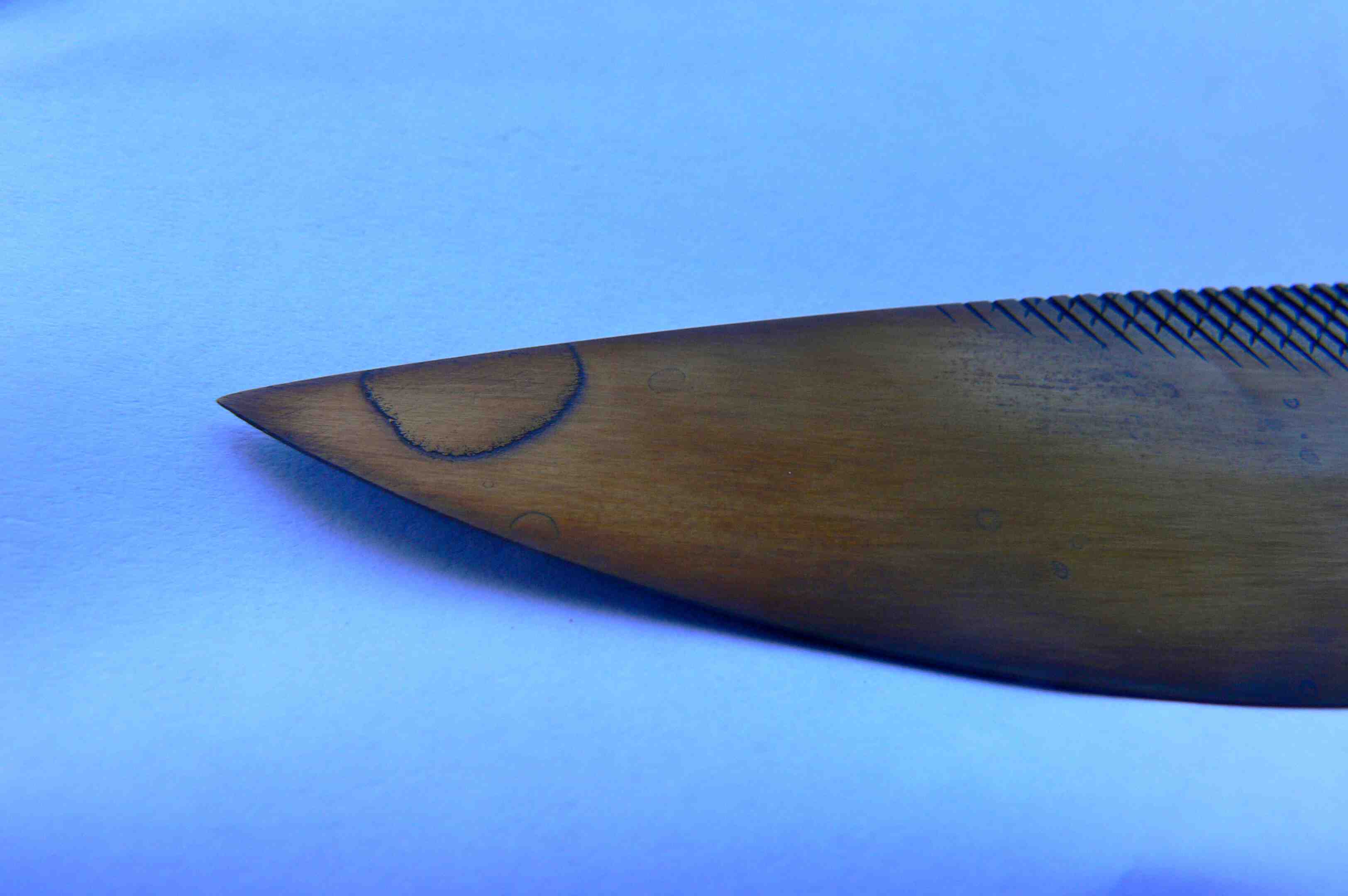

ok so i finally heat treated it today, did go as good as i had hoped, my dad was strongly saying that i didn't need to wear gloves, guess what, flames burnt my hands a little and it didn't go in as evenly as i wanted, the blade is a little bent but other then that i think it worked
heres a couple of pictures after its been hardened and the after being heated in the oven

What is that little blotch at the tip? Slag or a crack of some sort?
I'd suggest you try polishing and bluing the blade otherwise it'll rust quickly.
But overall it turned out pretty good so far.

looks like a crack, did you quench it in oil? did you try with a file that it is hardened? other than that it looks good
Est Sularus Oth Mithas
cheers guys
im not sure what that thing at the front is, there are some other smaller ones on there, i will try and sand them of but it will be hard
thanks, ill take a look into thatFnord wrote: I'd suggest you try polishing and bluing the blade otherwise it'll rust quickly.
i hope it isnt, yea i didjakethebeast wrote:looks like a crack, did you quench it in oil?
the darker part of the blade in the last photos is hard enough to not really be affected be the tip of a sharp scalpel, further back though still can be scratchedjakethebeast wrote:did you try with a file that it is hardened?
