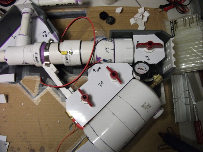

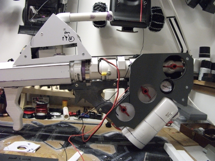

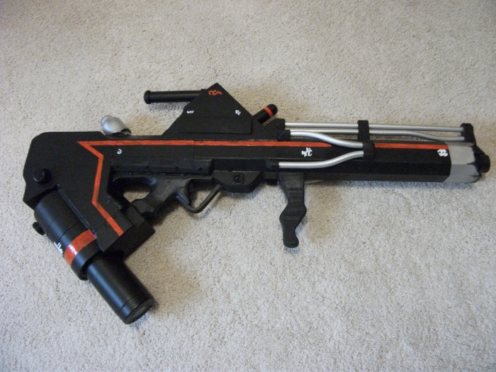

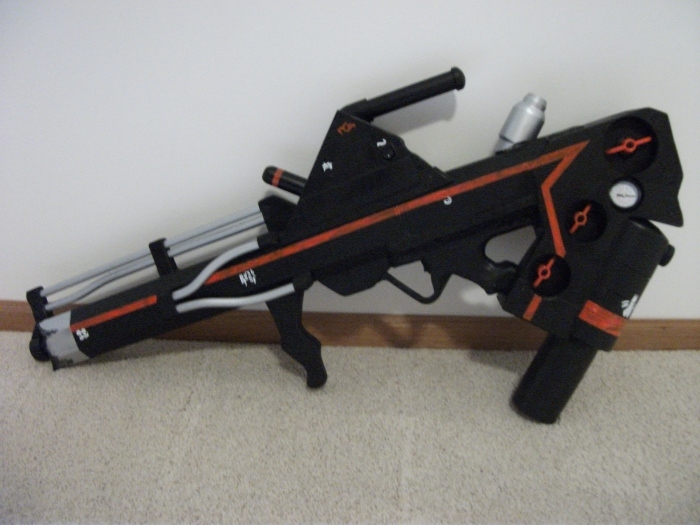

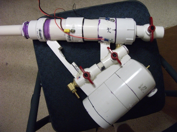

Latest triumph of PVC and sleepless nights. Somewhat replica of the District 9 gas projector gun.
Basics are:
1" barrel
2" x 9" chamber
tazer ignition
internal vent fan
metered propane
muzzle loader
All custom PVC parts

Wow! Where to start?
Amazing job picking a theme and sticking to it, amazing attention to detail, and amazing follow-through.
Didn't really get a chance to comment on your past submissions, so wonderful job overall!

Very impressive, kudos!
You've captured the look while integrating a metering system, brilliant. All we need now is to see it in action

Looks GREAT!! I was a little frightened by the delay in the video though!!
The PVC fabrication took the majority of time. With a few hours of work a week it took about 8 months to finish. Nice work on the airsoft M16.
I'm puzzled by the delay in fire as well, It happens every once in a while. I'm definetly getting spark each time but it took three sparks to ignite in the video. Any ideas?

probably fuel wasn't mixed well or you might have let it sit and the fuel collects at the bottom of the chambermarcin411 wrote: I'm puzzled by the delay in fire as well, It happens every once in a while. I'm definetly getting spark each time but it took three sparks to ignite in the video. Any ideas?
- Has thanked: 581 times
I love the way you patted it lovingly when it actually did fire
Could your meter calculations have been off?
the gas diffuses and forms a more homogenous mixture.
If you let it sit, it's even betterCrna Legija wrote:probably fuel wasn't mixed well or you might have let it sit and the fuel collects at the bottom of the chamber
