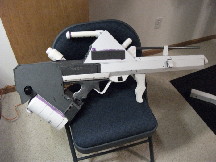

Latest triumph of PVC and sleepless nights. Somewhat replica of the District 9 gas projector gun.
Basics are:
1" barrel
2" x 9" chamber
tazer ignition
internal vent fan
metered propane
muzzle loader
All custom PVC parts
some guts
some guts
before the paint
before the paint
rear view
rear view
Left side view
Left side view

Wow! Where to start?
Amazing job picking a theme and sticking to it, amazing attention to detail, and amazing follow-through.
Didn't really get a chance to comment on your past submissions, so wonderful job overall!
Has thanked: 581 times
Very impressive, kudos!
You've captured the look while integrating a metering system, brilliant. All we need now is to see it in action :D

wow!!! I'm a huge fan of the District 9 guns.. and that is an awesome version congrats!

Thanks guys, I'll do a little video demo hopefully in the next week or so.

Test fire video added, enjoy.

Looks GREAT!! I was a little frightened by the delay in the video though!!

The PVC fabrication took the majority of time. With a few hours of work a week it took about 8 months to finish. Nice work on the airsoft M16.
I'm puzzled by the delay in fire as well, It happens every once in a while. I'm definetly getting spark each time but it took three sparks to ignite in the video. Any ideas?

marcin411 wrote: I'm puzzled by the delay in fire as well, It happens every once in a while. I'm definetly getting spark each time but it took three sparks to ignite in the video. Any ideas?
probably fuel wasn't mixed well or you might have let it sit and the fuel collects at the bottom of the chamber
I love the way you patted it lovingly when it actually did fire :D
Could your meter calculations have been off?
Crna Legija wrote:probably fuel wasn't mixed well or you might have let it sit and the fuel collects at the bottom of the chamber
If you let it sit, it's even better ;) the gas diffuses and forms a more homogenous mixture.

I usually see two pressure gauges on metered propane combustion cannons. Not sure where yours is connected exactly. Anyone wanna tell me how I can get by with one so I can save on costs?
You only need one gauge in the meter and that's it. Don't see the point in having two gauges unless one is on a regulator.
marcin411
Posts: 15
Joined: Sun Sep 12, 2010 6:57 pm
As MrCrawley noted one gauge is enough, I use one on the outlet of the regulator. This gives me a pressure reading and a fixed metered gas volume for setting the proper mix.
marcin411
Posts: 15
As an update I was getting a gas leak with the pvc meter pipe and have since switched to steel pipe and brass valves for the metering pipe. Live and learn.
