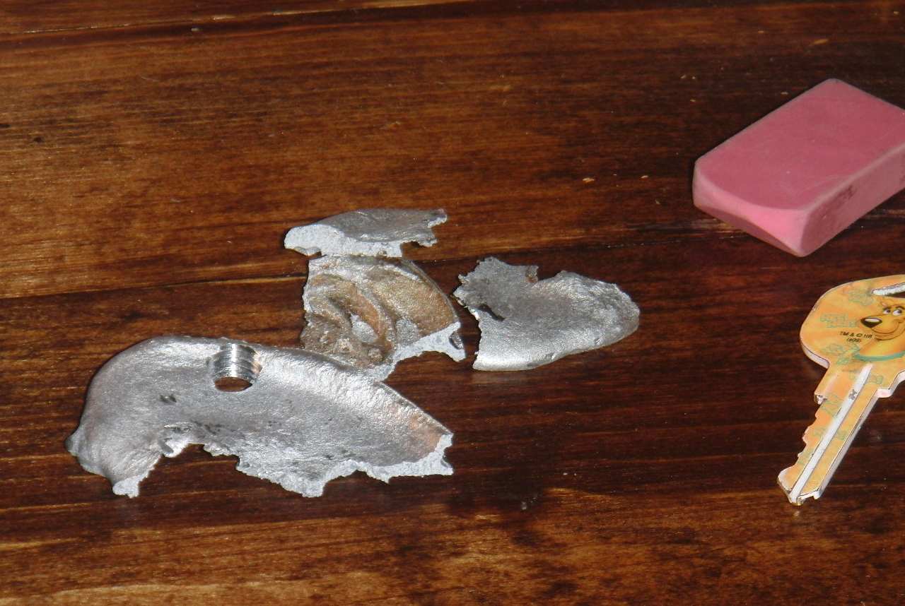

I just saw this earlier and had to try it out.
Stronger than cast aluminum, a little lighter and tougher than cast iron, and you can make it on a hot plate.
Link.
Basically, melt 71 parts zinc, and dissolve into it 27 parts aluminum and 2 parts copper. The copper takes awhile so you'll want to have it in there from the start. I just poured some into a puddle then tested its machinability by drilling and threading it, which was quite easy. The threads are a little rough, but that might just be my crappy harbor freight taps.
Finally I put it in a vise and broke it into pieces with a hammer and pliers. It's a little bit brittle, but still takes a good smack to break apart. I might play with the alloy ratios to see if it can be made softer.
This might be good for casting some hard-to-find small fittings.
So, while I go turn on all the fans in the house and drink a half gallon of milk, any thoughts on this? Seems like it could open up some options to those without an extensive machine shop.

Most likely... I bought a little $20 set from there thinking it would be good for a single use tap in stainless... not even close - nearly F'd up my whole part! When it comes to tools like that, HF is not my first choice lol.Fnord wrote:The threads are a little rough, but that might just be my crappy harbor freight taps.
Nice Scooby key btw.

You can use any heat source that gets over 800F or so. With a charcoal fire you could even melt and alloy brass, but if you're casting a lot you may want to pump some air to it with a fan or hair dryer.
For a container (crucible), any old steel container will do, but it would be better if it was a bit thicker than say, a soup can. A 2" steel end cap with a nip threaded into it will do fine. File a little spout into it so you'll have an easier time pouring.
BTB, it may also interest you to know this alloy seems to be good for casting because it really works its way into the mold well. Plain aluminum tends to ignore corners and fine details.

sure but I'd feel safer with something more malleable and less brittleBTB, it may also interest you to know this alloy seems to be good for casting because it really works its way into the mold well. Plain aluminum tends to ignore corners and fine details.

A modern US penny is 97.5% Zn and 2.5% Cu (80 parts Zn to 2 part Cu), which would be a reasonable starting point. Need to add Al and a little Cu.71 parts zinc, and dissolve into it 27 parts aluminum and 2 parts copper"

finally i find a thread that i can talk with some authority. ive been working in a foundry for over a year and doing metal casting as a hobby for over 5 years. the reason that alloy is so brittle is because of the zinc it makes alloys harder yet much more brittle. a good way to get your feet wet with this kind of thing is to start off with a charcoal fire with a little bit of forced air. most beginners use a steel crucible. DO NOT use a bean can they will burn through very quick and at the worst of times. the best bet is to use a stainless steel cup of some sort and line it with clay on the inside( so as not to absorb the iron from the steel.) i find that a decent alloy with alright strength and machine-ability is a brass that some call high brass its 65% copper and 35% zinc by weight personally i would add a small maybe .5% of aluminum to help with corrosion resistance. if any one wants to know more about metal casting don't hesitate to give me a holler .
