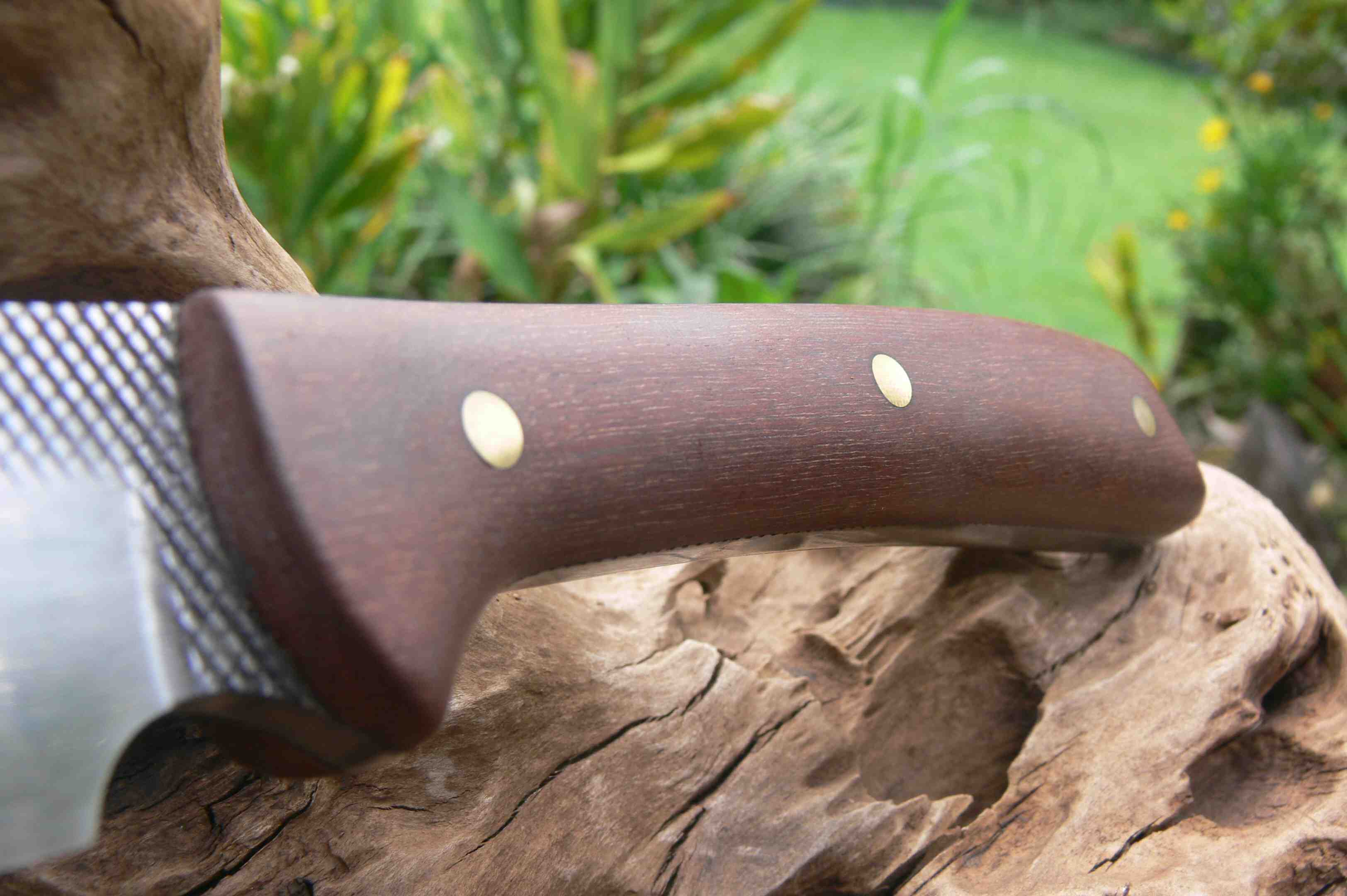

I know a little bit about it. I just gave a VERY brief synopsis. The key word is doing it "right". The heat treatment, whether it is standard or differentially treated, (to me) is dependent on what I want the knife to do. A lot of times, though, the differential heat treat isn't necessary on a file knife because of the spine. And by that, I mean the ENTIRE knife is a bit softer, say 50RC. If it's a smaller knife though, I tend to make it harder.jakethebeast wrote:Hubb, its necessary every time! cause hardened spine is very fragile, even though its thick, it will last you forever if you differential heat treat it RIGHT, you can always fail it hehe
Now, there are a host of other factors that come into play as well, and they can play just as important a roll as the heat treatment. For example, the smaller knives I've built usually have a flat or scandi grind whereas the larger ones will have a convex, and that convex edge works pretty well with a softer edged knife.
See, look what you done. You done got me ramblin' on about something else.
thanks for all the information guys
i cant really add much, still working on sharpening the blade, aslo the dimensions are, 16cm, 2.75cm wide blad and over all length it 29cm

"tell me what you think"
Not only can you stick/stab/cut something in self defense you can file them!
STOP! OR I'LL FILE YOU! LOL.
Looking pretty good, but how is it to hang onto?

you should give the handle a light coat of liquid electrical tape to make it a bit nicer to hold but not think enough to take the rough file marks out.
