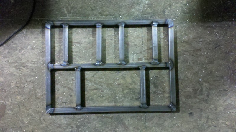

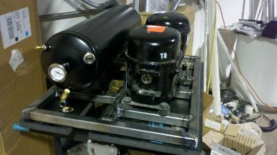

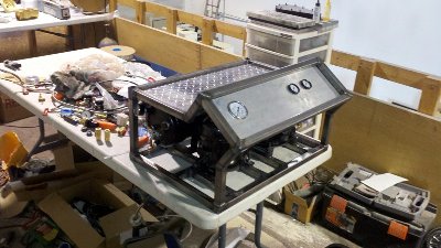

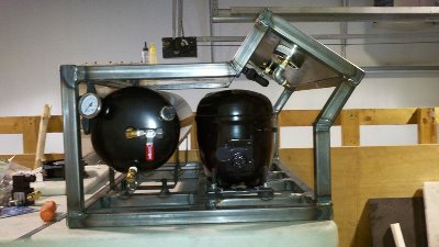

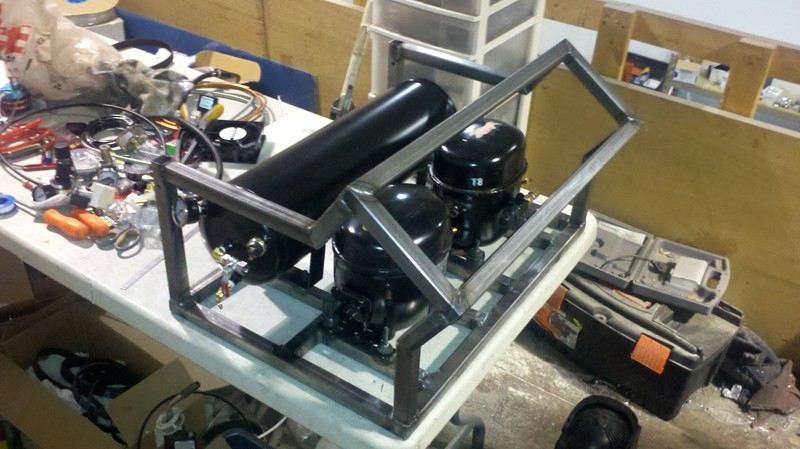

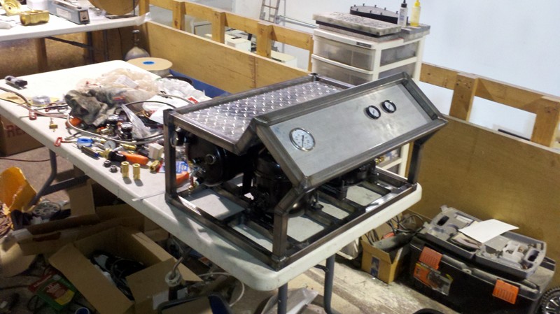

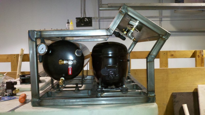

The frame is welded together and major components are test fit.
The frame will be powder coated safety yellow and all other plates and parts will be powder coated black.
I will update this thread as my time allows.

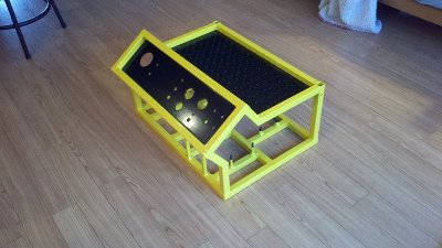

Some color...........
It is just back from the powder-coater.
Now for the fun part---- making the braided lines, running all electrical (an labelling the harness), and doing all related plumbing. I also need to letter the console with labelling and grouping of all related switches, lights, guages, and output ports accordingly.

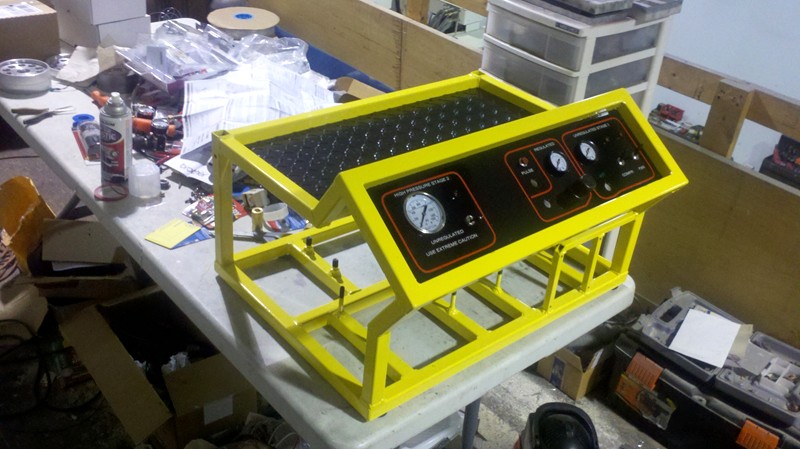

Console is lettered and bordered and cleared. The border is pinstripe. The letters are made on a P-touch label maker. Then I cleared over it with plastic headlight coating.
I have $15 spent on the console lettering and striping. Not bad.......
