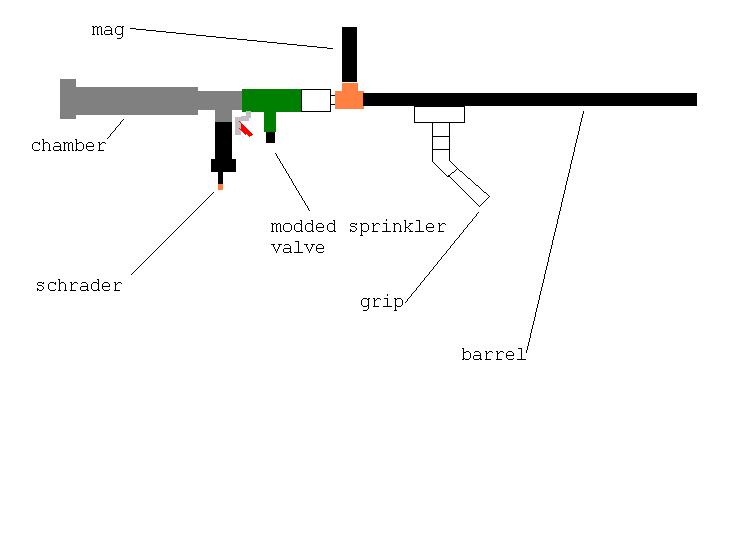

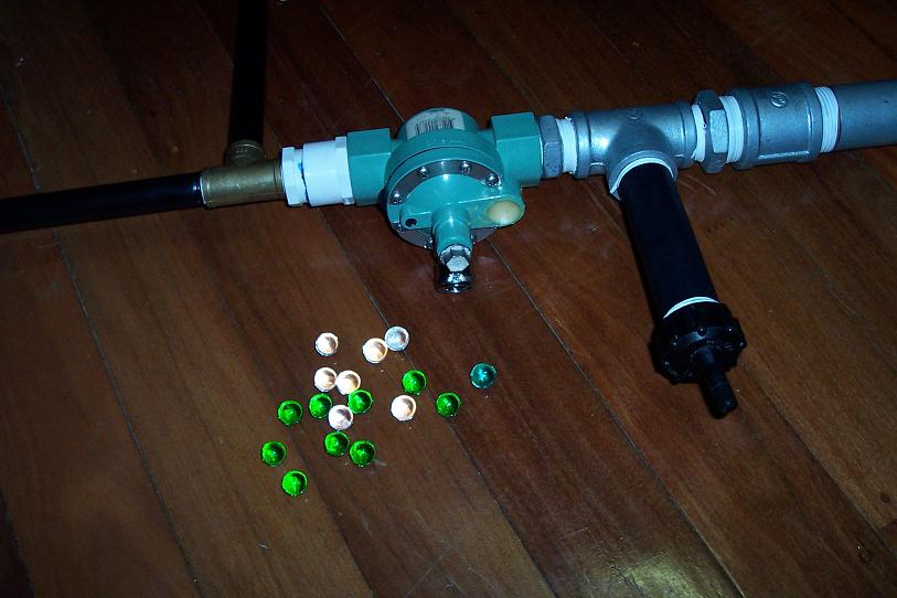

Here are the pics and some plans. Keep in mind this is my first modded sprinkler valve. I am really pleased with it, and used a quick connect incase i get a better blo-gun. I used a crappy one today, it still destroyed the drywall i have behind my house.
After tonnes of design sesions in my maths book at school and a brief chat with rna_duelers on how to resize the pics (thanks mate) this thing was born.

Cannon Name- Marble assault rifle
Type of Cannon- pneumatic
Chamber Size- 6 inch long, 32mm wide with an adapter leading to a 25mm handel
Barrel Size- 16mm, 50cm's long
-Pneumatic
--Gas Source- compressor, bike pump
--Valve - modded solenoid
--Other Special Details - Its fully auto!

My video camera isnt working atm. The chamber is a 6inch long peich of 32mm galvonised steel pipe.

My cheapish 12volt compressor, or if thats over heated, I use a high pressure bike pump.

nice, i thought it was still in the works, what sized barrel is that? 3/4" cpvc?

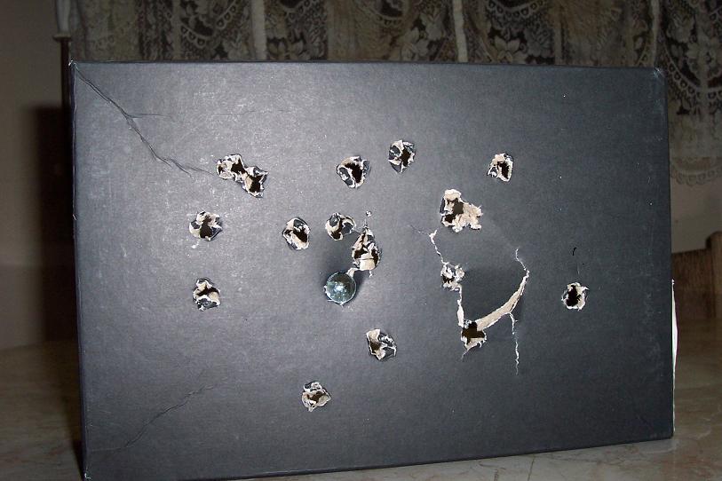

if i counted right, 17 shots in 3 seconds, thats 340 rounds/min
