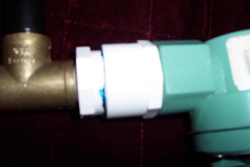

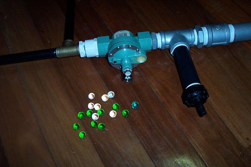

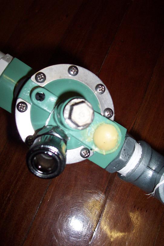

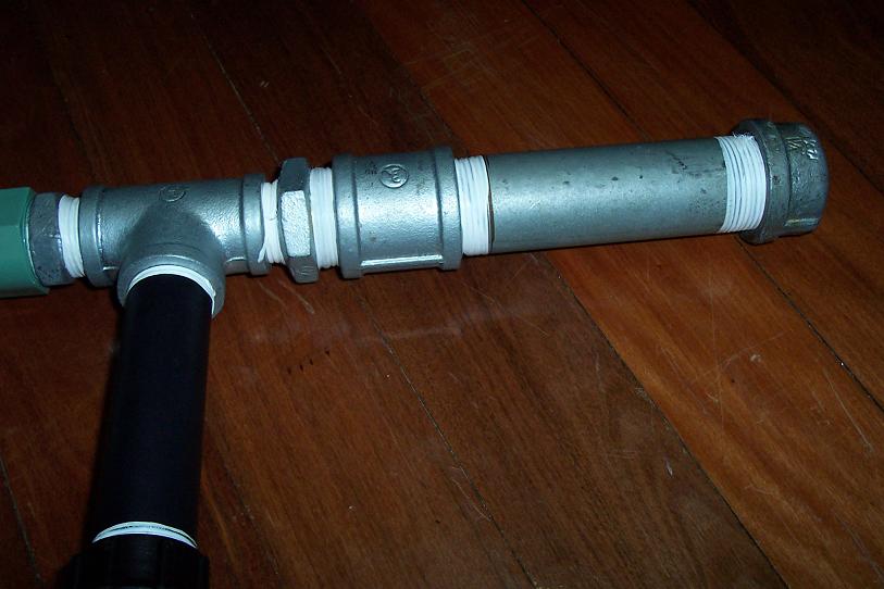

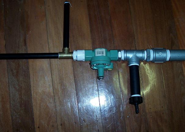

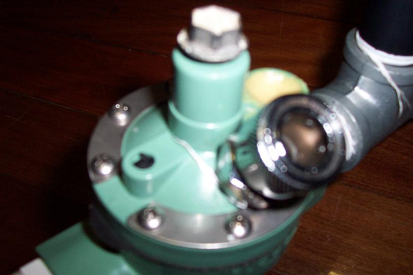

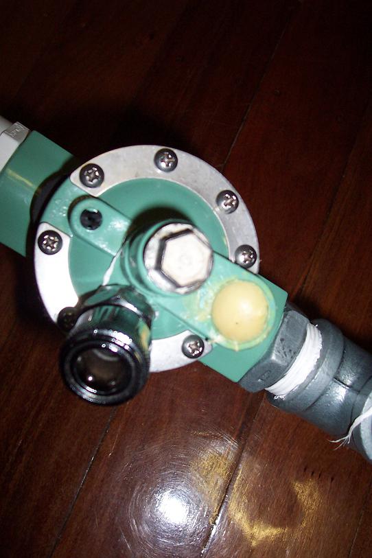

Here's my marble Assaust rifle. It's my most powerfull cannon TO DATE!!!

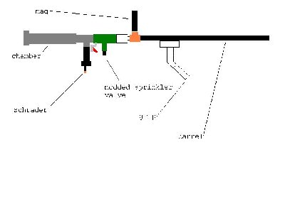

Here are the pics and some plans. Keep in mind this is my first modded sprinkler valve. I am really pleased with it, and used a quick connect incase i get a better blo-gun. I used a crappy one today, it still destroyed the drywall i have behind my house.
After tonnes of design sesions in my maths book at school and a brief chat with rna_duelers on how to resize the pics (thanks mate) this thing was born.
OK The build off requires I do this:
Cannon Name- Marble assault rifle
Type of Cannon- pneumatic
Chamber Size- 6 inch long, 32mm wide with an adapter leading to a 25mm handel
Barrel Size- 16mm, 50cm's long
-Pneumatic
--Gas Source- compressor, bike pump
--Valve - modded solenoid
--Other Special Details - Its fully auto!
the plans
the plans

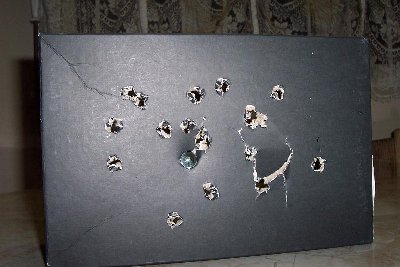

the damage shot at a cardboard box at 30 psi. This is after 3 seconds of firing.
quick connect
quick connect

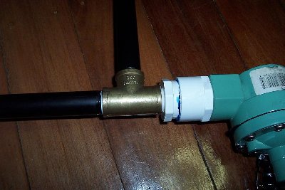

mag/valve conecter
mag/valve conecter

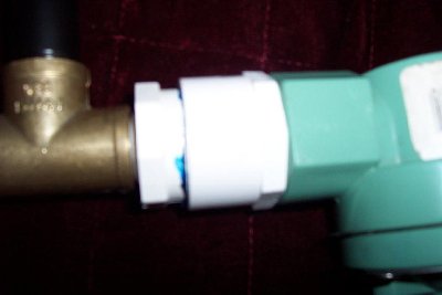

perfect fit
perfect fit

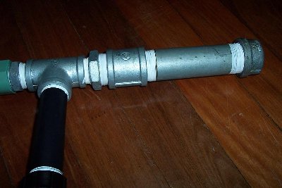

chamber
chamber
with ammo
with ammo
the mag
the mag
the first modded valve

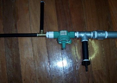

the beast
the beast

My video camera isnt working atm. The chamber is a 6inch long peich of 32mm galvonised steel pipe.

My cheapish 12volt compressor, or if thats over heated, I use a high pressure bike pump.

if i counted right, 17 shots in 3 seconds, thats 340 rounds/min
