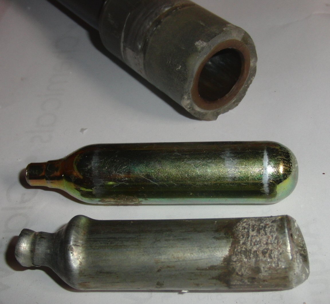

As to my latest fail, I found the projectile and the level of deformation after hitting a 1/2" thick sheet of chipboard backed up by a granite slab is substantial especially compared to a relatively unused CO<sub>2</sub> capsule.
Closer examination of the breech also illustrates the construction defects which allowed it to happen. First of all, the cross section of the barrel is discoloured in a similar manner to the inside, meaning it was exposed to the hot gasses on firing, giving them a surface to push on and ultimately crack the epoxy. Secondly, the 40mm o/d tube which I used to sleeve the barrel was not roughened on the inside, therefore not contributing any significant strength to the join and when the fail occured, allowed the barrel to pop clean out while the sleeve itself remained attached to the threaded fitting.

I doubt that would have helped anyway, the fundamental defect was allowing an exposed area where gas could attempt to force the barrel and threaded fitting apart.Fnord wrote:tsk tsk...jsr wrote:was not roughened on the inside
