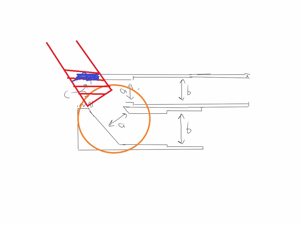

I've got a rough sketch of a part I may need machined in two parts out of aluminum, a is .68", b is the OD of 3/4" CPVC, and c is a 3/4" NPT thread
Any rough estimates for machining in the us?

That part is impossible to machine. It could probably be cast with some effort.
The part colored in blue is in the way of that angled part.

I wanted it in two halves, a lower part and an upper part

How are you going to join the halves together?
You could do this for a single block...
Changes are bold.<br />Drill, thread, plug.
Changes are bold.

That may work, but I want it to be a nice clean slope for my ammo to travel up. I can simply glue or hose clamp the halves together

Lockednloaded wrote:That may work, but I want it to be a nice clean slope for my ammo to travel up. I can simply glue or hose clamp the halves together
Pay to have nice parts machined then hose clamp it together? :?

you could just have it a bit wider and but a few bolts to hold them together.

I'm not sure what I'm going to do yet, but I'll be drawing up a formal drawing once I get a quote on how much it will cost from a local (US) machinist
