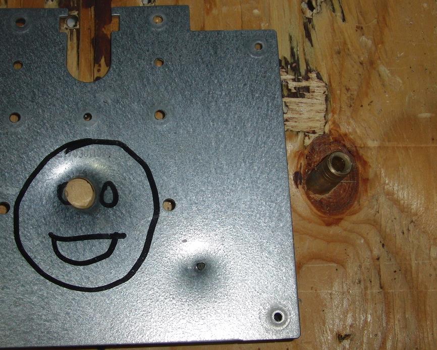

mix, projectile, launcher?
- Posts: 26220
- Been thanked: 352 times
15Labtecpower wrote:mix
12g CO<sub>2</sub> capsules cut in half and weighted with lead'n'epoxyprojectile
The subject of this thread, in this case with a 42mL chamber and 75cm barrel.launcher?

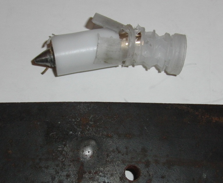

I decided to have another go at my nemesis, the hardened 1/4" plate.
Didn't quite go as planned, as a "tail" I put a push fit delrin tube, which seemed pretty tight. As always, I underestimated the forces involved. The inertia of the core on acceleration pushed it through the tube and into the shotgun wad, resulting in a very weird projectile actually hitting the plate. Still, pretty impressive damage.
