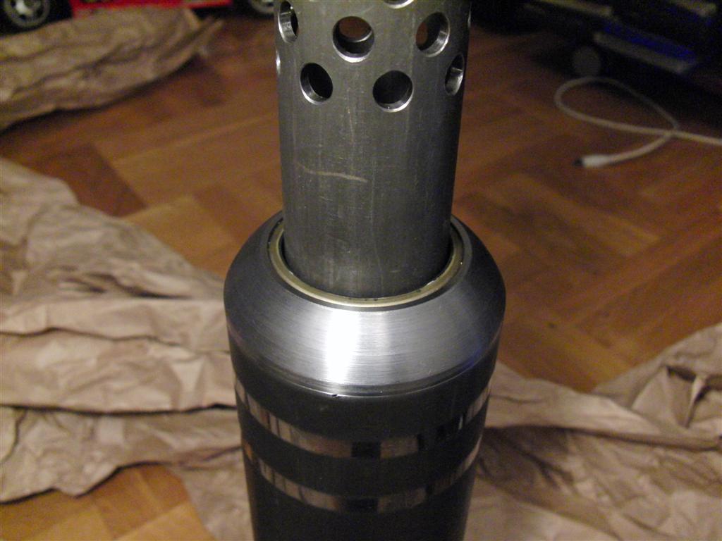

Last week i started a small summer project, a vehicle mounted airsoft gun.
A gun that you load with 90mm preloaded pneumatic cartridges.
Each cartridge consist of a 400mm long 90x5mm steel tube with threaded end caps, and a coaxial piston-valve that is piloted through a burstdisk.
The burstdisk is going to be punctured by a spring loaded, tube shaped firing pin.
Here is a few pictures during construction of the cartridges.
Push to test... Release to detonate.

I will probably mostly use them with 10-15bar pressure, but i believe that they would be safe to use with quite high pressure (tubing is rated to 220bar) .

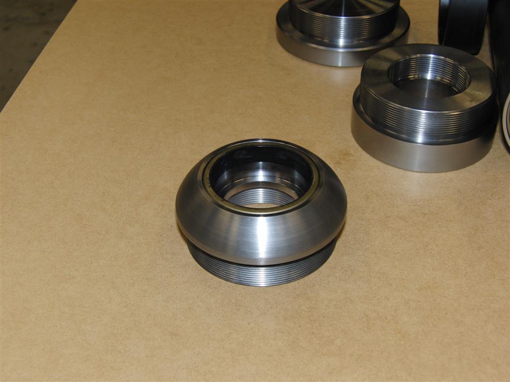

Some more work done and a few more pictures. :)
Now all the parts for all ten cartridges are finished, so i just started assemble them.
The threaded schrader valves i could find locally was to long (you can see one in the 4th picture) and i didn't had time to order from over sea.
So i bought 50pcs of tire-valves with rubber, and machined a threaded bushing out of brass that i could braze the brass parts from the tire-valves into.
LeMaudit
Posts: 665
all those shiny metal bits tingle me somehow... :D
I HAZ A BANG!
