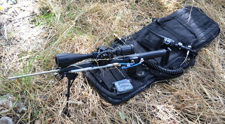

Finished, gonna make a suppressor tomorrow, not that it´s noisy but right now the barrel looks too skinny and I hope a air stripper style suppressor can improve the accuracy a little bit more(it´s already good).
Only used 5 bar for shooting this afternoon, neighbor are at home, but even through so after adjusting the hop up, effective range was 50m, measured with my laser range finder. If I turn the hop up a bit more I could reach 65m, but because the hop up isn´t perfectly leveled (a little bit turned to the left), the bb will turn to the left during the end of the flight :oops:
Will film a video tomorrow, also use higher pressure :)
BTW this gun fits perfectly in my m4 gun bag :D

Took it to the field today, it was really nice 8) but then the regulator got a problem and the output pressure started to increase so I had to stop shooting and empty the tank :x
Also filmed short video about the basic functionality of the gun
