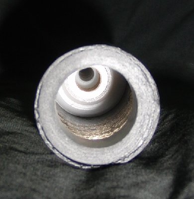

They certainly do - the last two I illustrated are for maxed out versions of this monster. Without the suppressor they literally sound like a firearm, but with the suppressor fitted you mostly hear the hammer hitting the valve, the difference is impressive.PaperNinja wrote:These have no effect on pneumatics right?
Considering material costs are around 5 to 10 euros per unit, and I can put one together in a couple of hours, I would say it's a fair price. Had I been making metal internals the manufacturing time would have risen considerably to the extent that I could not sell them for an affordable price.JSR, you said you were getting paid well for this.

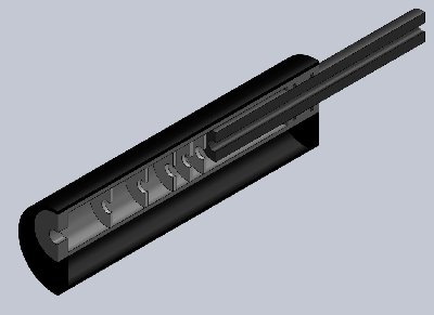

I made it similar to the Shinsung suppressors, but it slips over the existing shroud instead of being threaded and the first baffle area is perforated to allow air to expand into a large 70mm (around 2.75") diameter tube I slipped over. The eccentric design allows a large area without interfering with the scope line of sight.
3D rendering is the original idea, a little different from what I actually made.

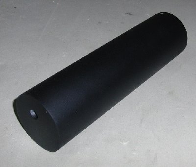

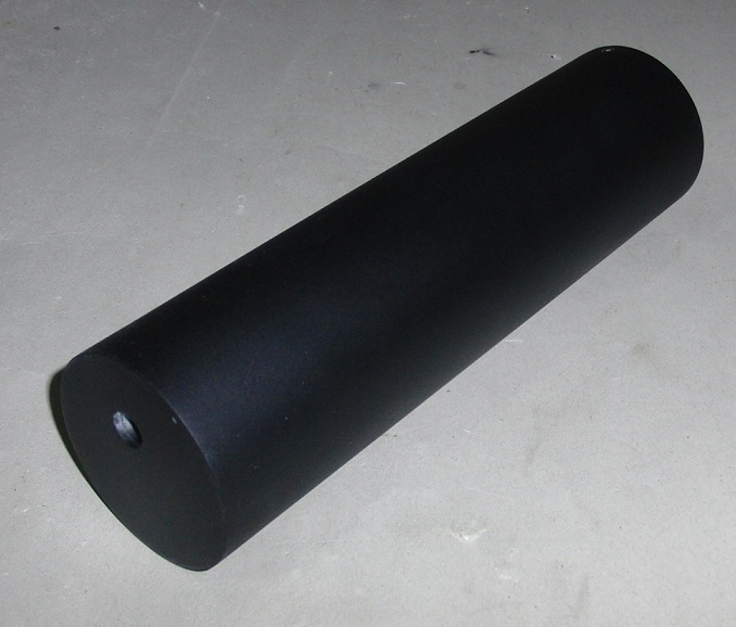

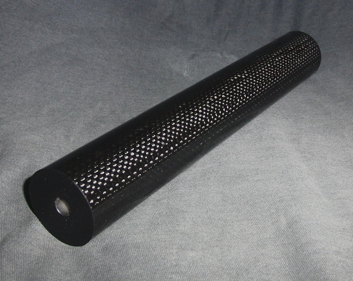

Thought I'd go a bit upmarket and give carbon fibre a go, tubing is quite pricey but the costs are happily passed on to the customer

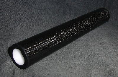

This one is also for an Evanix beast, it slips over the existing shroud and attaches via the 1/2" UNF male thread on the end of the shroud.

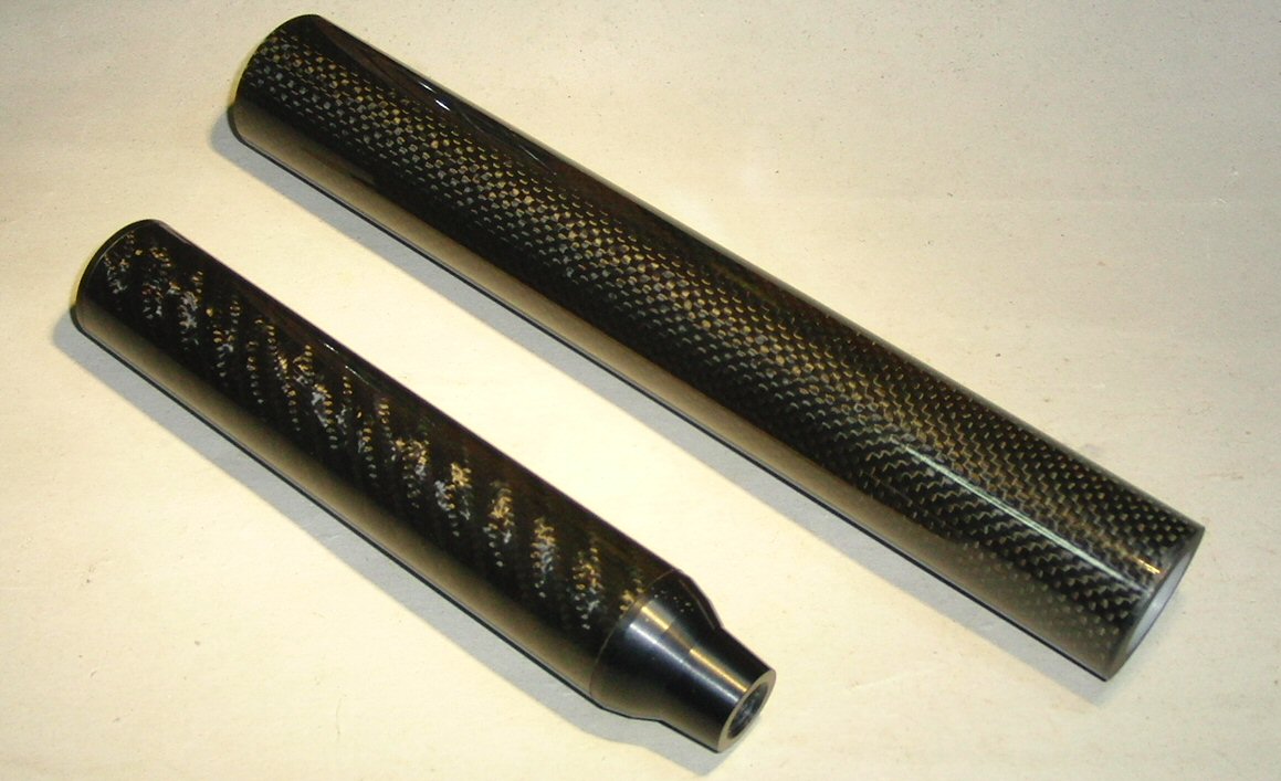

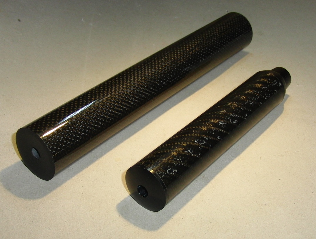

Here it is next to my Daystate Airstream CF silencer for comparison:

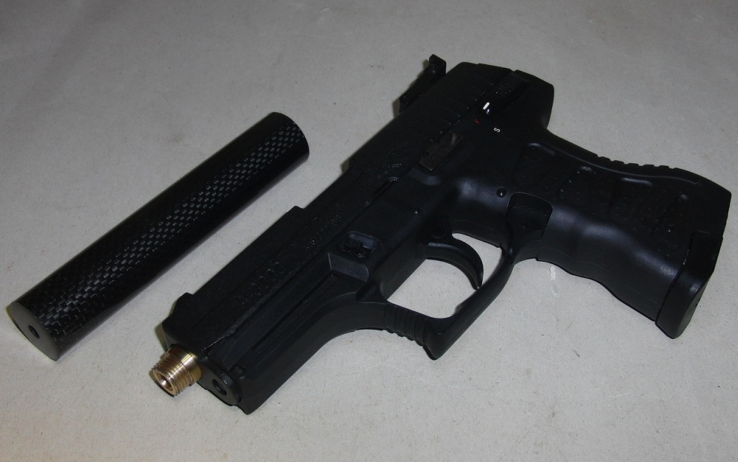

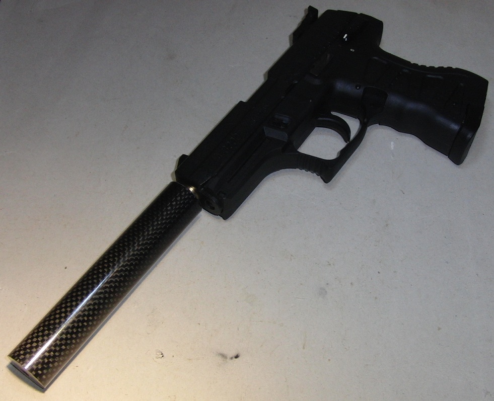

Some of you might remember the rather primitive suppressor I had made for my Anics A3000 "Skif" CO<sub>2</sub> pistol using lego blocks as baffle separators:

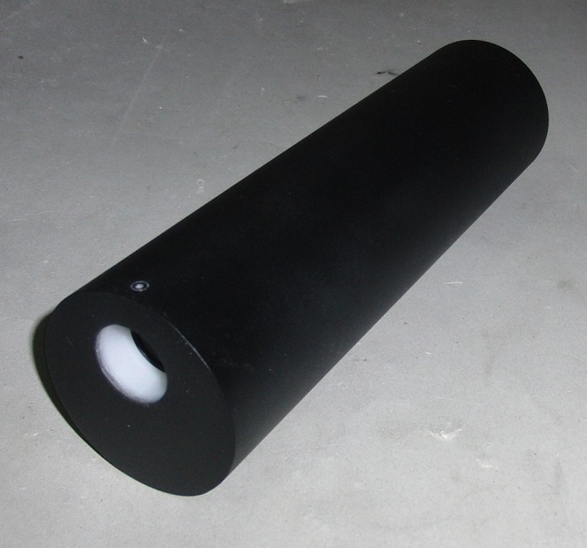

I decided to revisit the idea taking advantage of my improved fabrication facilities, herewith the result. Chopped off part of the plastic barrel sheath and epoxied on a brass sheath with a male 1/2" NF20 thread on the end, then made a 5" long 1" dia carbon fibre suppressor to fit, much smarter now

hehe nice! how effective is it?
Est Sularus Oth Mithas
No idea, no CO<sub>2</sub> in stockjakethebeast wrote:hehe nice! how effective is it?
