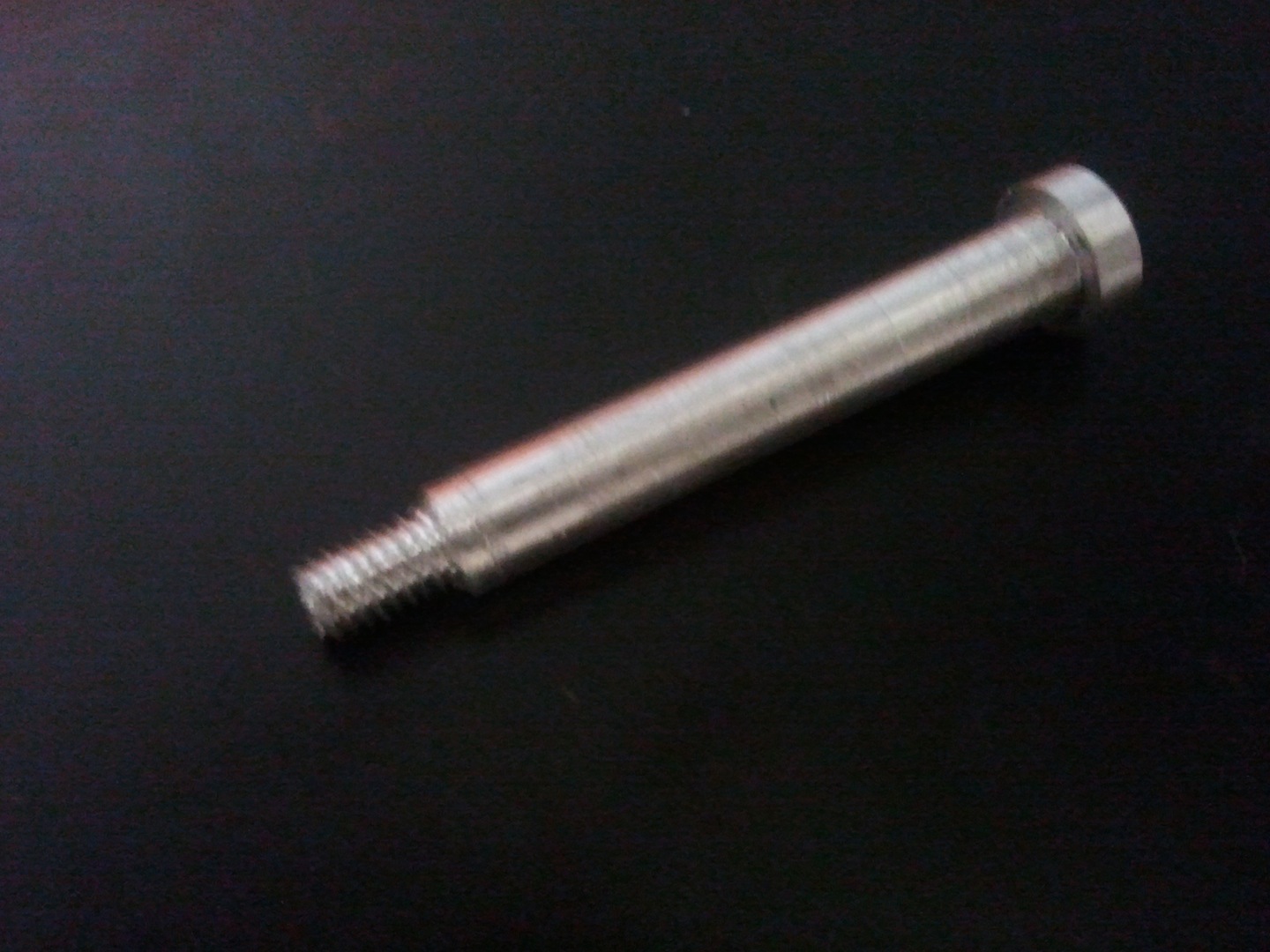

i cut some threads on pvc and aluminium using the change gears and made a simple bolt for a motorbike seat pivot from aluminium. i got the ali from a special aluminium dealer and the steel from a special steel dealer but im not too sure what alloy it is.

bolt which acts as an axle for the seat of a motorbike to pivot on when it is opened. lost the original while restoring the bike
