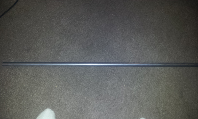

sweet both barrel and receiver block have arrived. the barrel is a 20mm od seamless stainless steel pipe with a 3mm wall thickness.
barrel
barrel

That's pretty cool man ... How r u gonna bore out the block and how much did you pay for the stainless steel barrel and where did you get .... What's the calibre your aiming for or what size do you want :) ?
