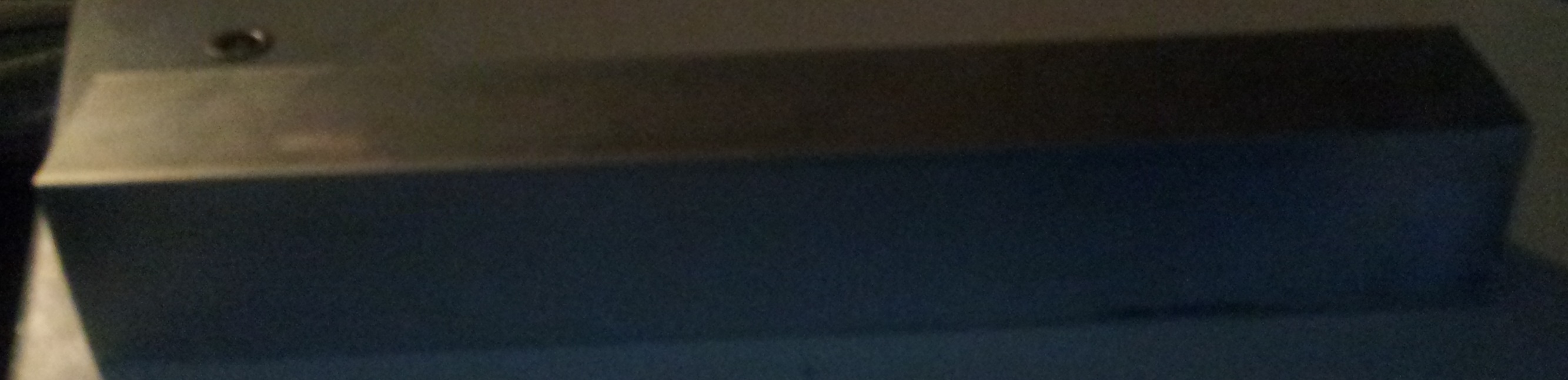

rite my billet of aliminium is here
archie370
Posts: 112
Joined: Sat May 05, 2012 7:02 pm
Location: US
That's pretty cool man ... How r u gonna bore out the block and how much did you pay for the stainless steel barrel and where did you get .... What's the calibre your aiming for or what size do you want :) ?
