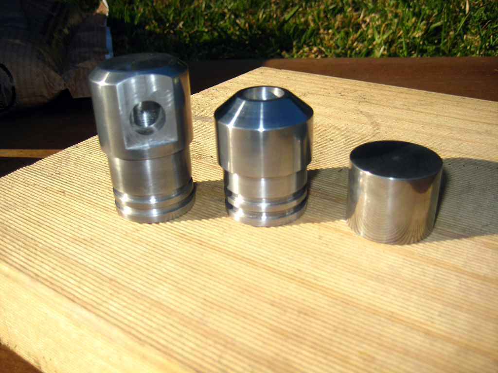

Made up the other end cap today.
Looking very good, this is going to be the bee's knees when it's done :)

Didn't get a whole lot done today.
My o-rings arrived, woot, I actually got something right! Thankyou Parker O-ring Handbook. http://www.parker.com/literature/ORD%20 ... ndbook.pdf
Machined up the barrel and chamber. Yeah I know, I scratched the heck out of the barrel with the steady rest on the lathe. Hopefully it will sand and polish out.

I plan on plunging a 20mm slot drill into the piston to make the cup shape as JSR advised.
I have the 1/8" BSPT tap to tap the schrader into the bottom of the blow gun, once again following smirking Jack's advice. Not sure if I want to just cut the hook off or cut the whole thing a bit shorter.
Might even make a new chamber to get rid of that ugly scratch . . .

I have a heap of those little self adhesive silicone feet to use as a bumper. 7 of them fit quite nicely on the end cap (each one is about 8mm round).
To attach the caps I will be drilling and tapping for 3 or 4, M5x8mm button head screws.
I'd considered forgetting the o-rings and epoxying it all together but I prefer to have the ability to strip it down / rebuild it if needed.
Why didn't I thread them on ? Good question. Short answer; I suck at cutting threads.
