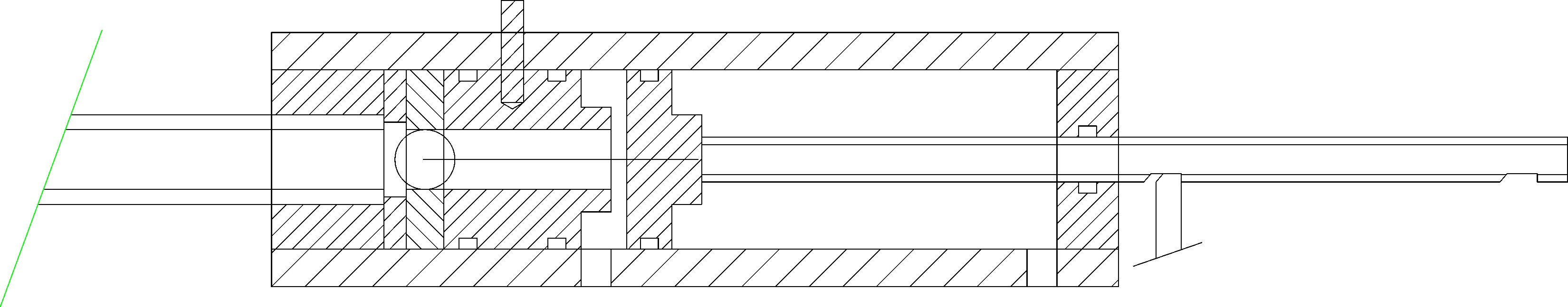

I did a drawing of my thoughts so far and have attached it. The ball and washer assembly would be replaced by a rifled piece of tube and projectile.
The lead projectile would be swaged into the small piece of rifled tube to produce burst disk pressure. Once the release pressure has been achieved the projectile will move down the rifled piece picking up the spin until it enters the barrel. The rifled tube could then be later be used again. (Sorry about the pic quality. Gets better when you zoom in. Also the design is far from complete, I just put enough detail to give you some idea of where my mind is at.)
I can see what you're trying to do, the physics is sound but translating it in practice is going to need a lot of thought and effort. Is it something you want to do for the sake of it, or is there some sort of performance target you have in mind?
