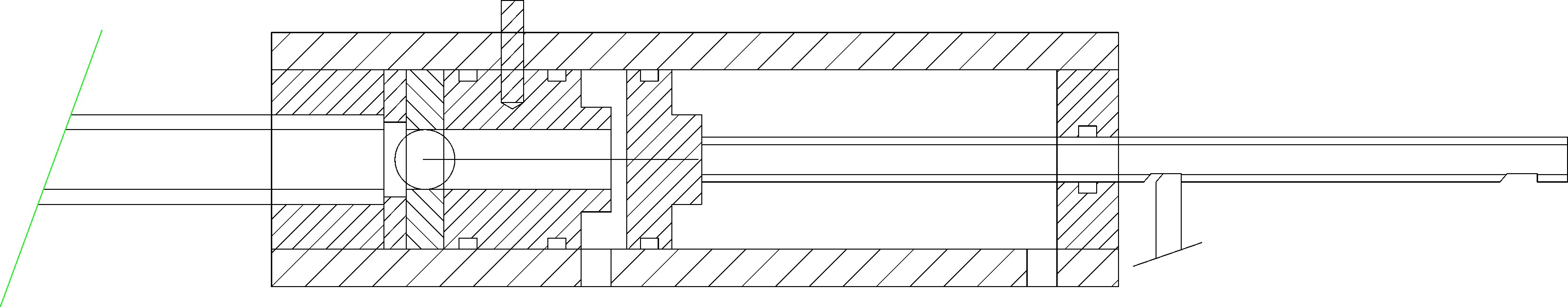

I did a drawing of my thoughts so far and have attached it. The ball and washer assembly would be replaced by a rifled piece of tube and projectile.
The lead projectile would be swaged into the small piece of rifled tube to produce burst disk pressure. Once the release pressure has been achieved the projectile will move down the rifled piece picking up the spin until it enters the barrel. The rifled tube could then be later be used again. (Sorry about the pic quality. Gets better when you zoom in. Also the design is far from complete, I just put enough detail to give you some idea of where my mind is at.)

After reading through the link you provided I realise I still have a lot of thinking to do.
If this is your first project, it's definitely quite an ambitious one.

I can see what you're trying to do, the physics is sound but translating it in practice is going to need a lot of thought and effort. Is it something you want to do for the sake of it, or is there some sort of performance target you have in mind?I did a drawing of my thoughts so far and have attached it. The ball and washer assembly would be replaced by a rifled piece of tube and projectile.

@Heimo: with regard to the 5.5 ammo I hear you. The second important criteria to that law is that it may not be above 6 ft*lb, is it even worth making a hybrid to accommodate the law then?
well hehe thing about hybrids they are only as powerful as you want them to be at a given time, meaning their power is easily adjustable if you adapt your mixes thus it can be legal if it needs to be at a given time...Alanstone wrote:
the hybrid I am still dreaming about is something that is pump action and with every stroke of the pump, the correct amount of fuel is automatically injected for that given volume of air then for example you can have low mixes and high mixes with minimal effort other the amount of pumping involed
The voices in my head may not be real, but they have some good ideas!
