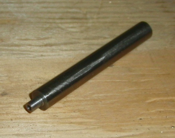

killerbanjo, here's your part:
![kbpart2.jpg (180.76 KiB) Viewed 2421 times kbpart2.jpg](./download/file.php?id=23081&t=1&sid=8456fcef30889999abf3ad7f15585ff0)
![kbpart1.jpg (102.07 KiB) Viewed 2421 times kbpart1.jpg](./download/file.php?id=23082&t=1&sid=8456fcef30889999abf3ad7f15585ff0)
