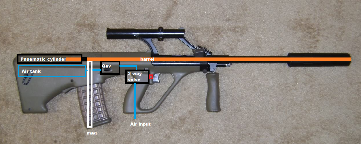

While doing more research today i saw your semi with a pneumatic cylinder Wyz. It seems to be a far simpler way of doing what i want to do, and auto feeding rounds. all i would need is a small detent to stop the rounds rolling out
id love to stuff it all in the body of a steyr but im insure it would fit. Anyway to trigger the 3way if i where to move it into the stock?
edit- Can i use a solenoid 3way valve? that way i can just trigger it with 12v. If yes, do i get limited with the pressure i could put thru it
- POLAND_SPUD
- Posts: 5402
Most valves are rated to 8-10 bar and you can usually use them at slightly higher pressures than thatCan i use a solenoid 3way valve? that way i can just trigger it with 12v. If yes, do i get limited with the pressure i could put thru it
but don't worry even 8 bar is more than enough for airsoft

i was looking at using one of these for the feeder
http://www.ebay.com.au/itm/360517335274 ... 983wt_1139
The listing says the ports are 4.5mm. im using these push to connects everywhere else
http://www.ebay.com.au/itm/251221046454 ... 1423.l2649
Is there a 4.mm to 1/4 adapter i can use? or 4.5mm to 1/4 push to connect? havent had much luck

Use a single action cylinder, a lot easier.
12 solenoid work, kind expensive comparing to manual ones through
The 4.5mm port is for a specific push to connect fitting for cylinders, you need to search for them. I don´t know any adapters.

Alright all of my parts are ordered, other then a tube for the mag and the air tank the gets hooked up to the qev. The only question i have is does it matter what size airtank i use? i want to get a decent rof out of it, so if its to big it would take to long to fill, but if its to small it would rob power yes?
the barrel is 6mm and will be firing mostly steel bb's, barrel is 700mm long atm, may change in size when the steyr body rocks up so i can measure
the main tank will be a paintball tank in a back pack
A 13 cubic inch tank is a good balance between number of shots and bulk, you can easily mount it on your launcher:
The Ninja tanks have shim adjustable regulators that can go down to 450 psi without the need for an additional reg, saving you bulk and money. At that pressure, you probably don't even need a firing chamber, just block off the QEV port.
