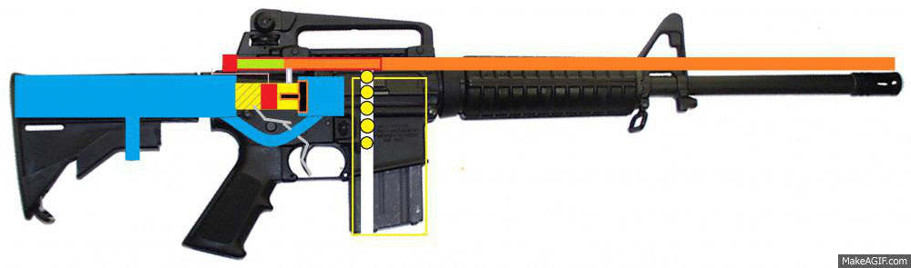

If you want power, go for piston valve, that gives you alot of power
But i didnt quite get your idea from what your picture though..

some power would be nice, but not needing heaps, trying to get as many shots out if a tank as i can.
to try and explain. The blue box at the back in the air tank with a input in the bottom. That then connects with a line to a second smaller air chamber, with a hammer valve in it (orange box) the hammer is connected to the trigger with a sear. When the triger is pulled it will release the hammer, causing air to flow past the valve, up the red tube, then into the barrel. To reset the hammer and chamer another round, you pull the charging handle at the back. The handle has a small bit on the bottom that pulls rod attached to the hammer to re-cock

Basically you would need some kind of a valve between reservoir->firing chamber, other than that i see no problem for it working, only some PITA o-rings

He is using a hammer valve.jakethebeast wrote:Basically you would need some kind of a valve between reservoir->firing chamber, other than that i see no problem for it working, only some PITA o-rings

thats pretty much it jsr, though the issue i had with that design is i want to use mags. If i have the valve like that i can see issues

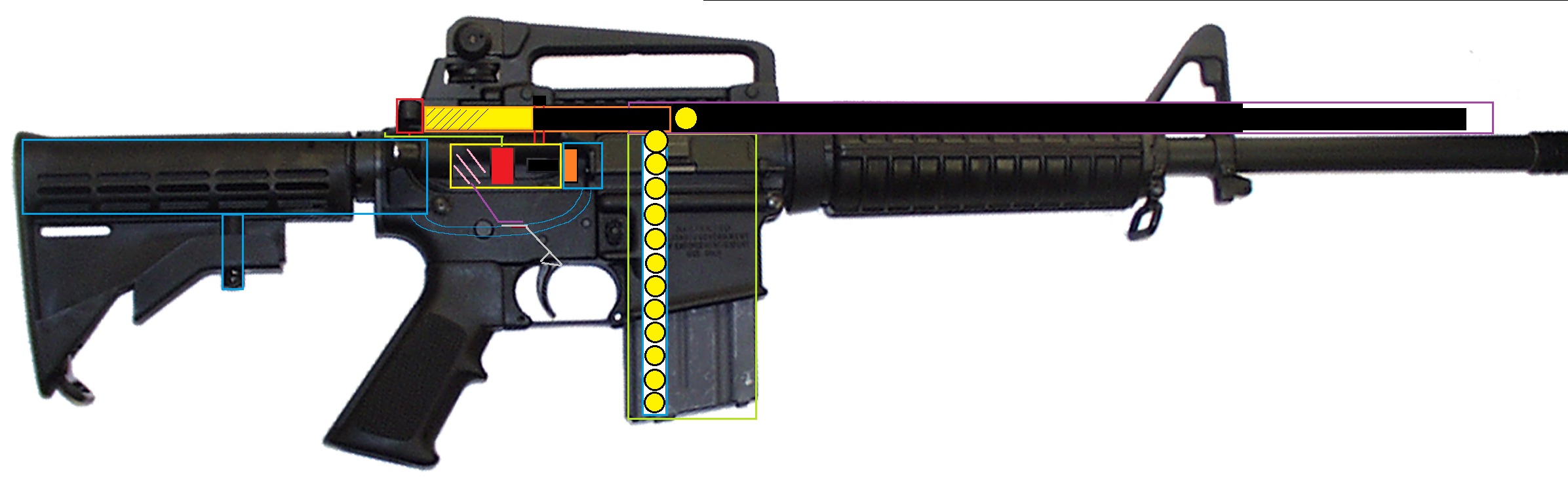

This was my other idea with a blow back, it would waste air, but would mean semi auto, with only needing to chamber the first round (not after full auto)
i should have left the airtank in the back a lighter color because it woulent decrease much with the hammer valve in the firing chamber
excuse my gif quality

Just looked closer at the blowgun valve, can i drill a hole for a chamber anywhere? if i can put it underneath then it would probably work for me

Unless you have a really tight bore and really heavy projectile, that probably won't work.

Tight bore wouldent be a problem, but pellet weight would. Didnt think it would just work
