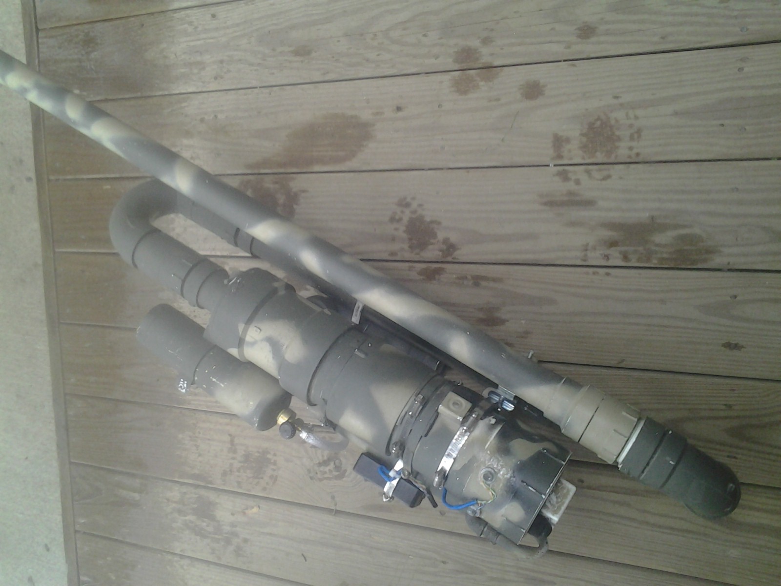

this is actually an attachment I built for my latest build. my launcher has a chamber size of 19.5 inches in length and a volume of around two hundred and fifty cubic inches. having that much volume in the chamber I needed to have a barrel length of almost 10 feet long with the barrel being 1.5 inches in diameter. I have a CB ratio of about .8:1 now.
the reason for my new build was because I kept vaporizing potatoes every time I would fire them out of my gun because my barrel was way too short. my original barrel was about 52 inches long at 1.5 inches in diameter. and now I'm right around 110 inches in length. I built the gun based on a trombone. There is a huge difference in the gun with the new upgrade. Potatoes never exexplode in the barrel and it is much quieter. It still has an awsome kick to it and it can send a spud several hundred yards away!!!!

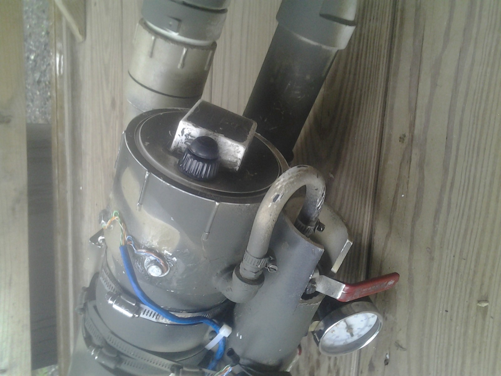

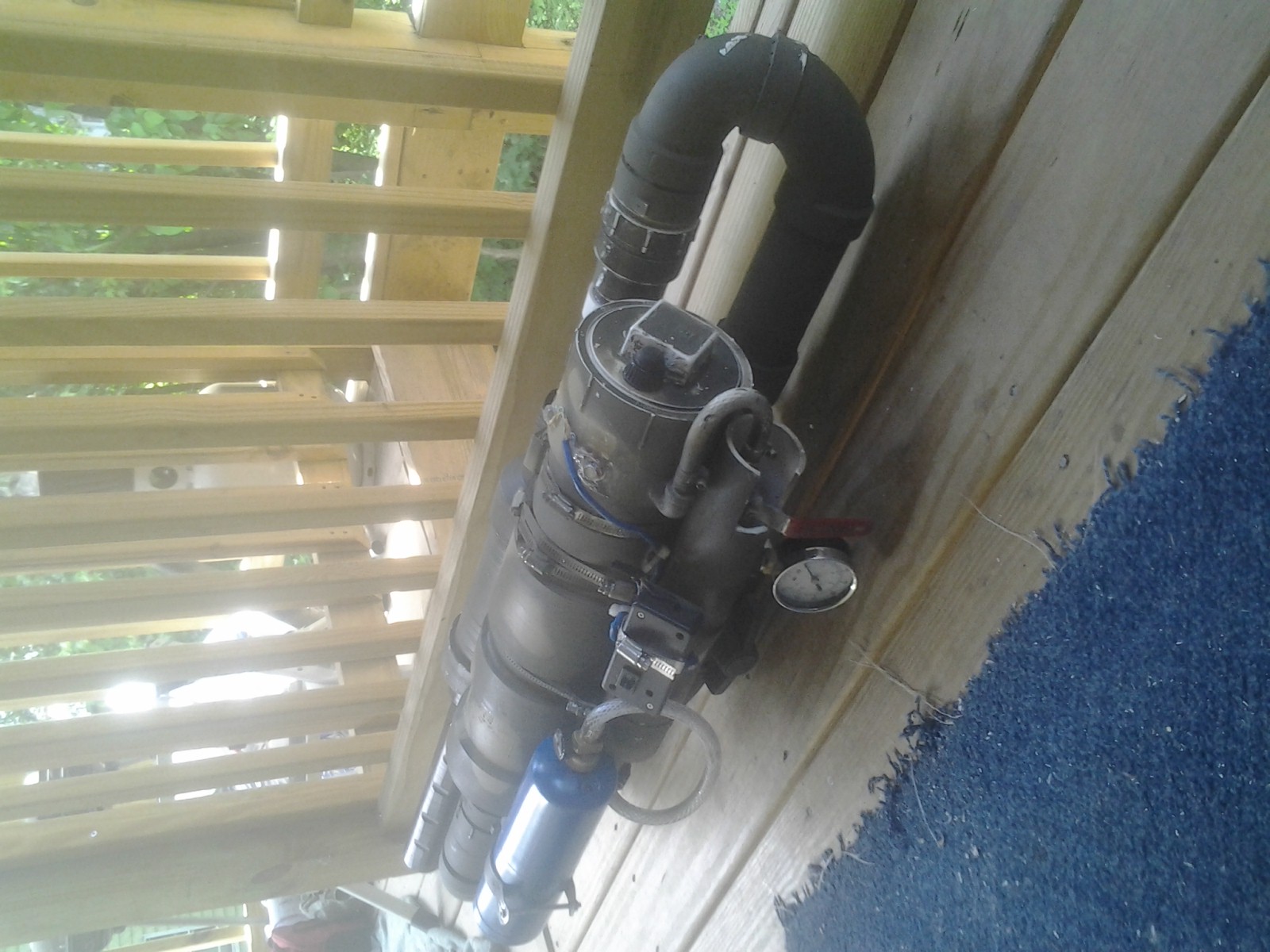

I have my meter inside pvc . Also the gauge and meter ball valve are in a tight cluster and out of the way. On the end off the clean out cap is my ignition button. The step up transformer is on the other side of the cap or inside the chamber.
Overhead pic of new gun.

Here u can see the ignition button. I'm using a12kv step up transformer. Inside the chamber I'm using 2 perforated circuit boards for my multi spark ignition. A board at each end of chamber.
Close up of controls
