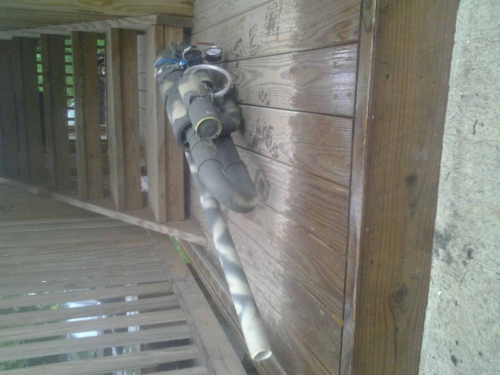

expansion barrel for large chamber launchers
this is actually an attachment I built for my latest build. my launcher has a chamber size of 19.5 inches in length and a volume of around two hundred and fifty cubic inches. having that much volume in the chamber I needed to have a barrel length of almost 10 feet long with the barrel being 1.5 inches in diameter. I have a CB ratio of about .8:1 now.
the reason for my new build was because I kept vaporizing potatoes every time I would fire them out of my gun because my barrel was way too short. my original barrel was about 52 inches long at 1.5 inches in diameter. and now I'm right around 110 inches in length. I built the gun based on a trombone. There is a huge difference in the gun with the new upgrade. Potatoes never exexplode in the barrel and it is much quieter. It still has an awsome kick to it and it can send a spud several hundred yards away!!!!

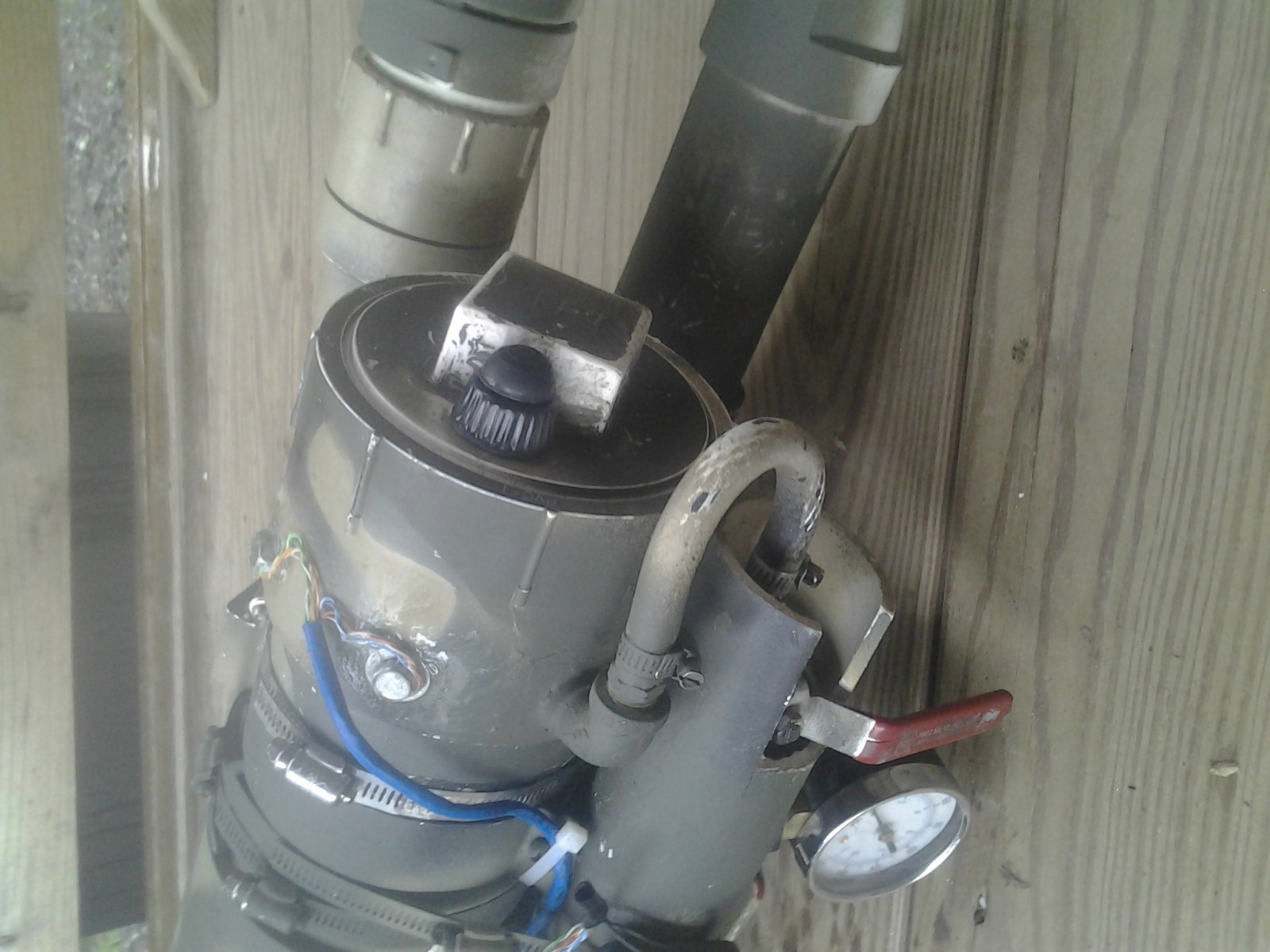

I guess I was being modest when I said a few hundred yards. I haven't measured it yet but this gun is amazing!!!! There is a park down the street from my apartment that has three baseball fields and a soccer field. From the parking lot I shoot spuds over everything into the woods that lie beyond the freeway!!. When I shoot my compound rounds or when I have the golf ball barrel on I lose site of those projectiles. I would really like to get this gun chronied. Its gotta be shooting in the 500 fps area. Ill post some more pics. I do have a question though. When I fill my chamber with the mapp, its usually around 40-45 lbs, I keep the chamber ball valve open and run my internal fan for 8 seconds. Then I shut fan off and close the chamber valve then fire. It's perfect everytime. It's that the normal way every gun works?? I heard that when u release the gas into the chamber the chamber should be sealed already? If someone could let me know. Thanks.

What's a qdv bro?? Also I used the wrong word when I said vaporize earlier. Basically I was blowing the spuds apart before they came out of the barrel. Before this upgrade of course. Now it's perfect. The math on all my formulas came out perfect too. I checked it against latkas calculator. This gun, although a little heavy, is a pleasure to shoot. So much power yet sooooo smooth

My spuds were breaking up for 2 reasons. First was my barrel was too short. Second was the spud cutting edge sucked so I was beating the potato down the barrel. Therefore I compromised the integrity of the vegetable!! Not to mention hitting it with a monster blast of mapp didn't help!!! Lol! God I love spud gunning!!
