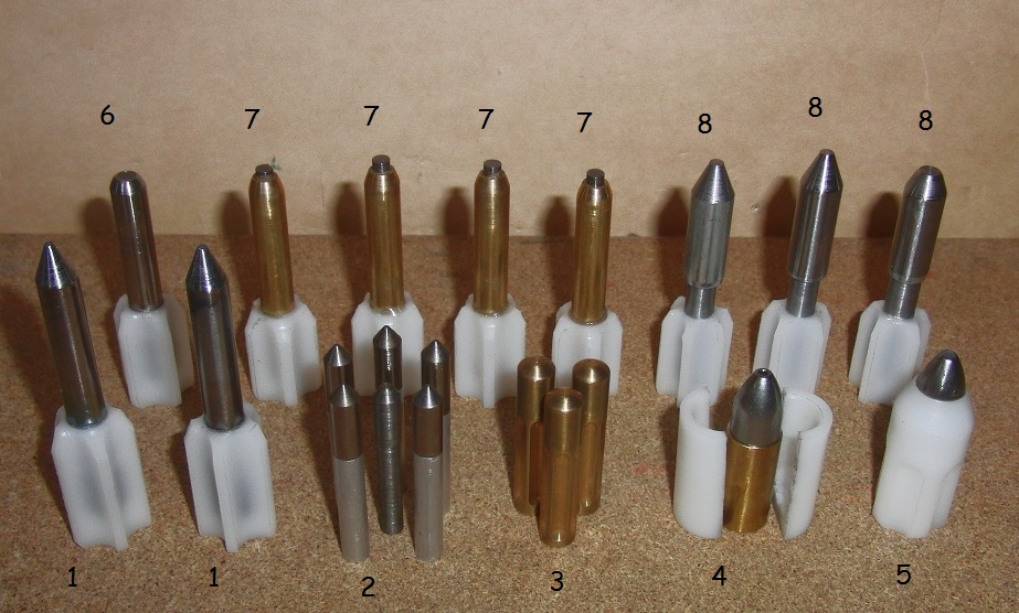

Here's the latest stock:
1 ) Mild steel darts from some rod I got from an old printer, this time just under 1 ounce and heat treated
2 ) 5 x mild steel darts with aluminum tails, with a central all steel dart
3 ) 3 x all brass darts
4 ) subcalibre dart with 3/4 oz tungsten head and hollow brass tail
5 ) full calibre dart with 3/4 oz tungsten head and delrin body
6 ) mild steel dart with 4mm tungsten carbide cores
7 ) brass darts with 4mm tungsten carbide cores
8 ) steel darts made from 8.8 structural grade bolts

How did you made the sabot of n4? I mean how did you cut them in the middle? Also how did you heat treated the steel?

wyz2285 wrote:I mean how did you cut them in the middle?
On the mill with a slitting saw:
In a very amateur way, heated until red hot and then thrown into a bucket of water :)
