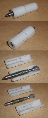

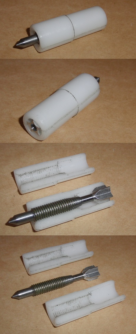

The balle sauvestre uses two sabot "petals" and seems to work well enough.

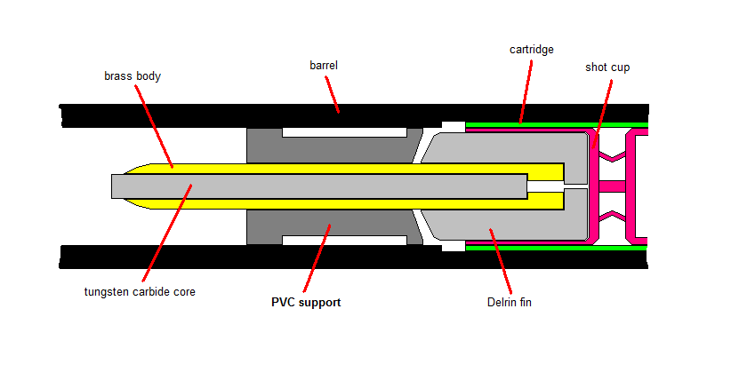

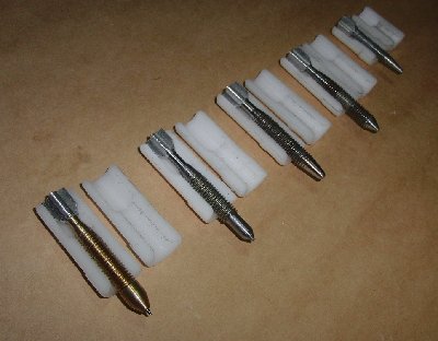

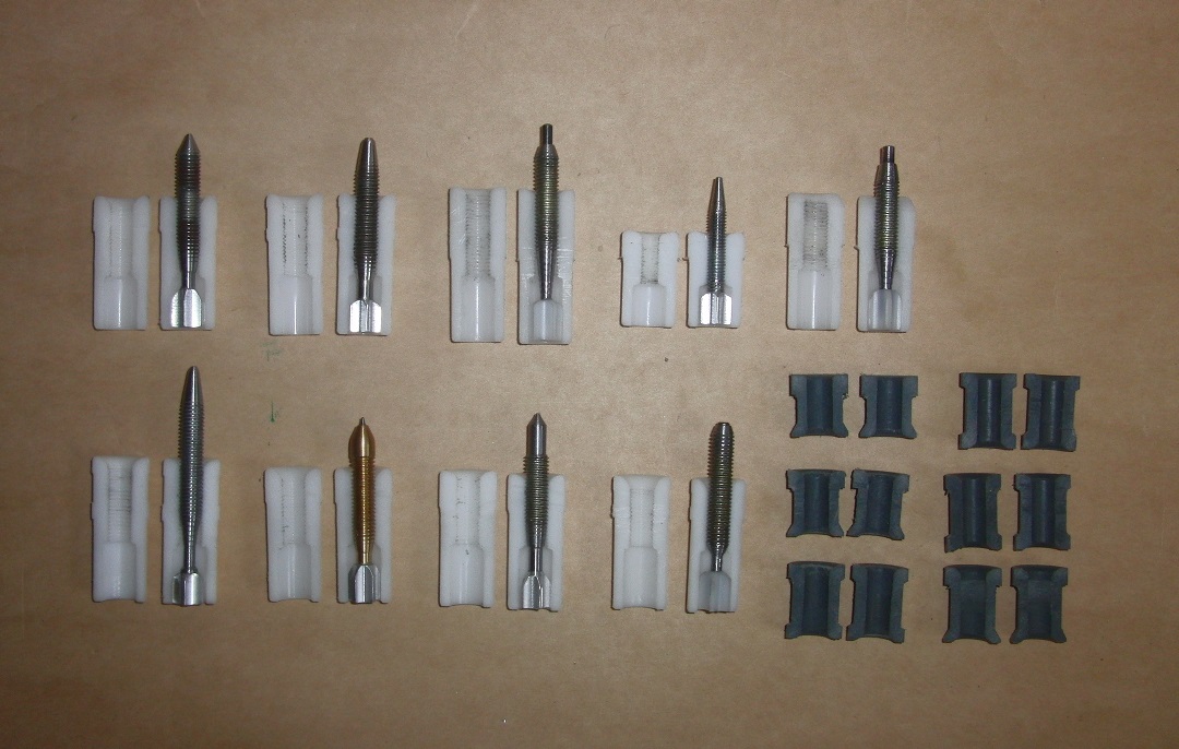

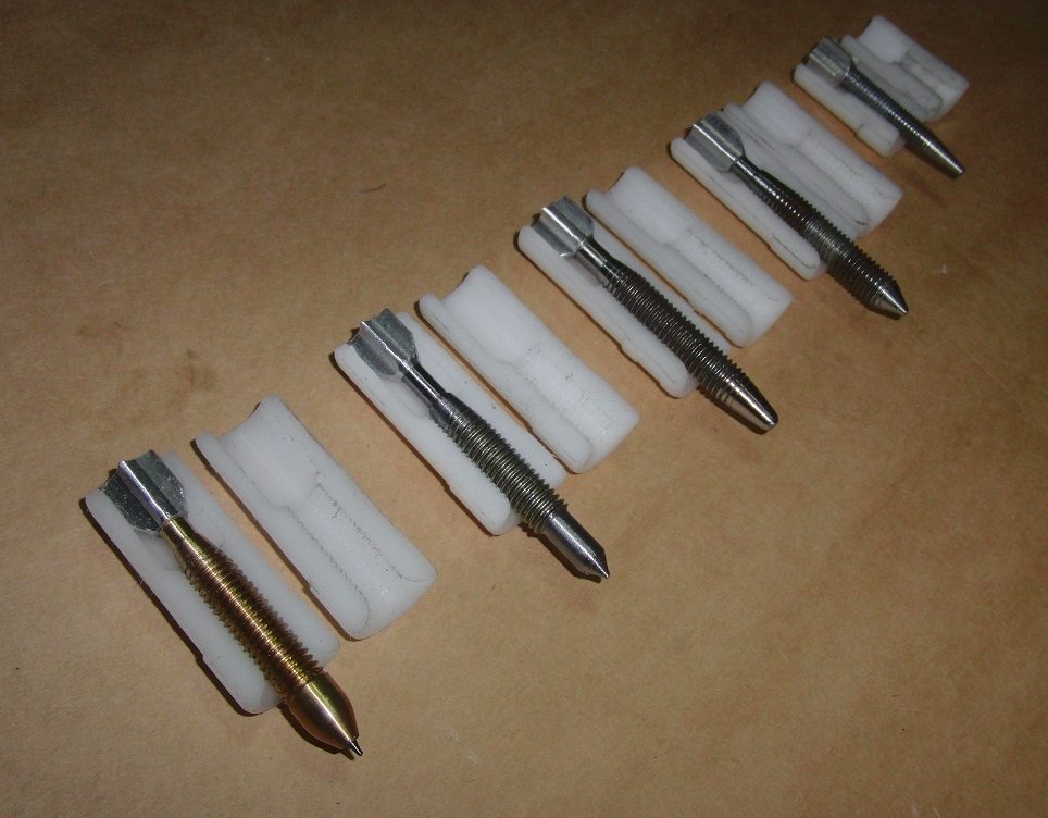

I'm confident these will work so I made four more:
Latest package for taofledermaus, aside from the saboted rounds I also made some PVC supports to stop the previously made projectiles with fullbore fins from twisting in the barrel in the hope that they will survive firing, as in the diagram.
