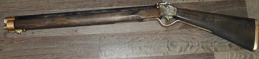

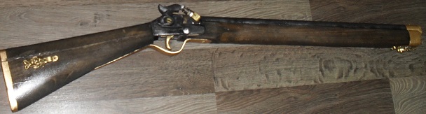

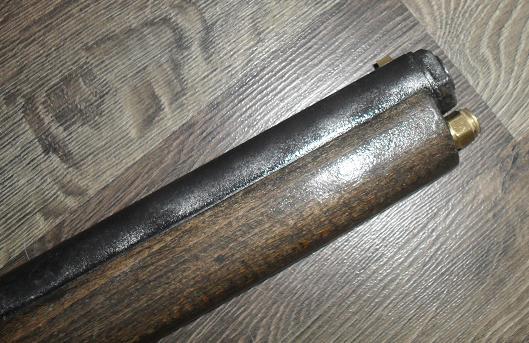

I've made some iron ( brass) sights...made the tunnel for the ramrod, a brass tip for the rod...In the bottom picture it's partially pulled out.
You can barely make out the front sight.It's triangular seen from the front, just a piece of brass..Rear sight is fixed.

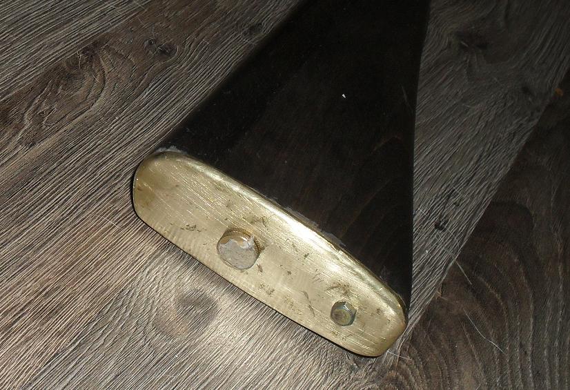

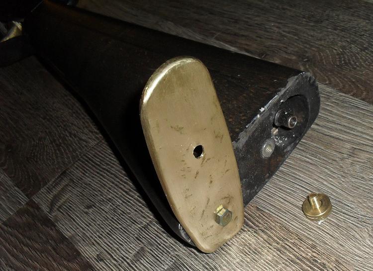

And I made a buttplate out of brass pipe.
I cut it, folded it open,( PITA!!) flattened it and hammered it into shape by hand.
Like panelbeating..?
The edges are now curled.
I really enjoyed the process.
Not a perfect fit and you can clearly see it's been hammered...but I kinda like it..
Only time will tell how well I can clean it up.
I'll fix up the damaged paint later after I completed the fit to the stock.
The buttplate can be rotated after the centre screw is removed by hand.
The other bolt will be replaced by something better suited for the job.

It was the only way to get a piece large enough...but I'm not satisfied.
I want a perfect fit.
..so I might be doing some more hammering...or scrap it the minute I find something better.
I'll think it over first..I'm starting to wear myself out.
I do realise that the brass tip I had wanted to do under the barrel can't be done now that the ramrod is there.
It would be too hard to pull out the rod...unless I'd have it stick out even further, wich I don't like...
maybe I'l make some sort of brass thingy just to finish the theme, but I won't be extending the stock slightly past the muzzle to get the "massive-agressive" look I'd like.

I found heating it up then clamp it in a vise left a better surface than hammering. Repeat the process until you get a large enough foil
It's not the surface I'm worried about, it's the rounded edge not fitting the stock properly and the lack of sufficient thickness.
A 100% fit would give it enough support against the stock but without it, the 1mm thickness means it's wobbly.
I'll get it right, just not sure when.

Added some gold/brass paint and some ( actual) brass lionhead sling attachment thingies...
