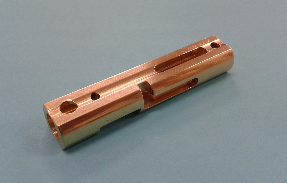

Comedy aside, here's the brass breech block I just finished, next to the naff stock plastic one:
Here's the underside:
It started off life as a 3/4" round bar, I loosely based the dimensions on the plastic one but made no attempt to replicate it. Nice and shiny but I don't think I'll polish it much more, I want to black it eventually anyway.

Nice looking breech Jack. I prefer em in black too, but polished brass can look great on the right gun.
I didn't see any rails milled in, is it just set up for for the stock sights?

I'm guessing you went with the flat top for accessories?
