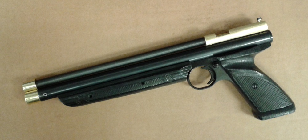

FragmentedSanity wrote:Nice looking breech Jack. I prefer em in black too, but polished brass can look great on the right gun.
Cheers :) I have mixed feelings about having it shiny, it looks like a slippery slope... before you know it I will make a brass trigger, safety, wooden grips...
I didn't see any rails milled in, is it just set up for for the stock sights?
Nope, I have access to all sorts of ready made rails at the shop so as GF pointed out I left the top flat to eventually bolt a rail there for a red dot sight.
I would also like to mod the sear spring, something like this:
Speaking of hybrids... now that you have access to machining and are quite skilled at it - have you considered building a small handheld hybrid ?? for example pistol sized and equiped with a bolt lock?

jackssmirkingrevenge wrote:I have mixed feelings about having it shiny, it looks like a slippery slope... before you know it I will make a brass trigger, safety, wooden grips...
A slippery slope indeed, and you're already on the way down. :wink:
Nice work on the receiver. :)

Gippeto wrote:A slippery slope indeed, and you're already on the way down. :wink:
Yup... slippery as the ground in Quebec is at the moment!
Cheers :) made the bolt as well, only the muzzle block left!

Are you intending to add a grub screw or two to solidify the barrel/receiver connection or did you make it a reasonably snug fit?

Gippeto wrote:Are you intending to add a grub screw or two to solidify the barrel/receiver connection or did you make it a reasonably snug fit?
I was going to cut it is very snug and the muzzle clamp I made puts it under tension anyway. Not exactly free-floating but hey :)
Here it is, ready for some power testing :D

Some better pictures, all it needs is the rail now:
I put some Crosman Premier hollowpoints through it, no chrony at the moment but shooting at a pine 2 x 1 20 pumps will put the base of the pellet a quarter inch below the surface, not sure how it compares to the previous performance though :roll:

Tomorrow I will add a length of Picatinny rail and re-do the muzzle part, it's slightly undersize so the barrel is not exactly parallel to the pump tube and I think it will look better if it is longer than the pump tube plug. I am really, really tempted to thread it...
