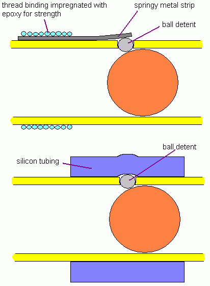

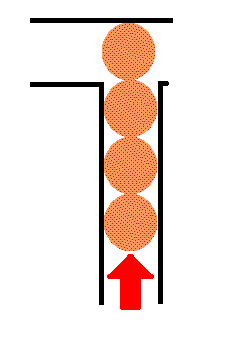

Consider a simple Tee magazine with a detent
A pic of a detent

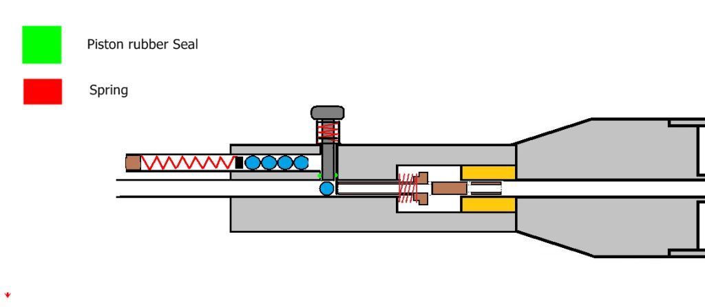

Or add a return spring with the bolt, similar to this
But the T-mag and the mech in your pic will be easier to construct than the one with spring.
