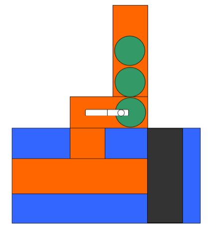

How about this?
I know Hi drew the T inside the coax a long time ago. I just added the loader on top.

@Lentamentalisk: If I'm looking at that correctly, is it just a T fitting on the end of the barrel, sticking out of the chamber? We've been discussing that one, but the problem is sealing off the T, unless it gets capped airtight between every shot.
@keep_it_real: That looks interesting, but I'm kind of confused by it and need more details. What exactly is that white piece in there, and what does it do?
Part of my wild idea was to make a bolt that actually attached to the piston, so when the piston went back, it could load a round/seal off the T magazine. I'm still working on that one.

the white thing is just a bolt. when the bolt is back, ammo drops into the bolt. Push the bolt forward and it drops into the barrel.

It doesnt have to be sealed airtight, only fairly well sealed. All of the other models require a 1" barrel or less, due to the sprinkler valve restrictions, and a union of sorts with a gigantic ramrod. This way only takes a screw in end cap, or if you want to get all fancy you could use a nice union too.
