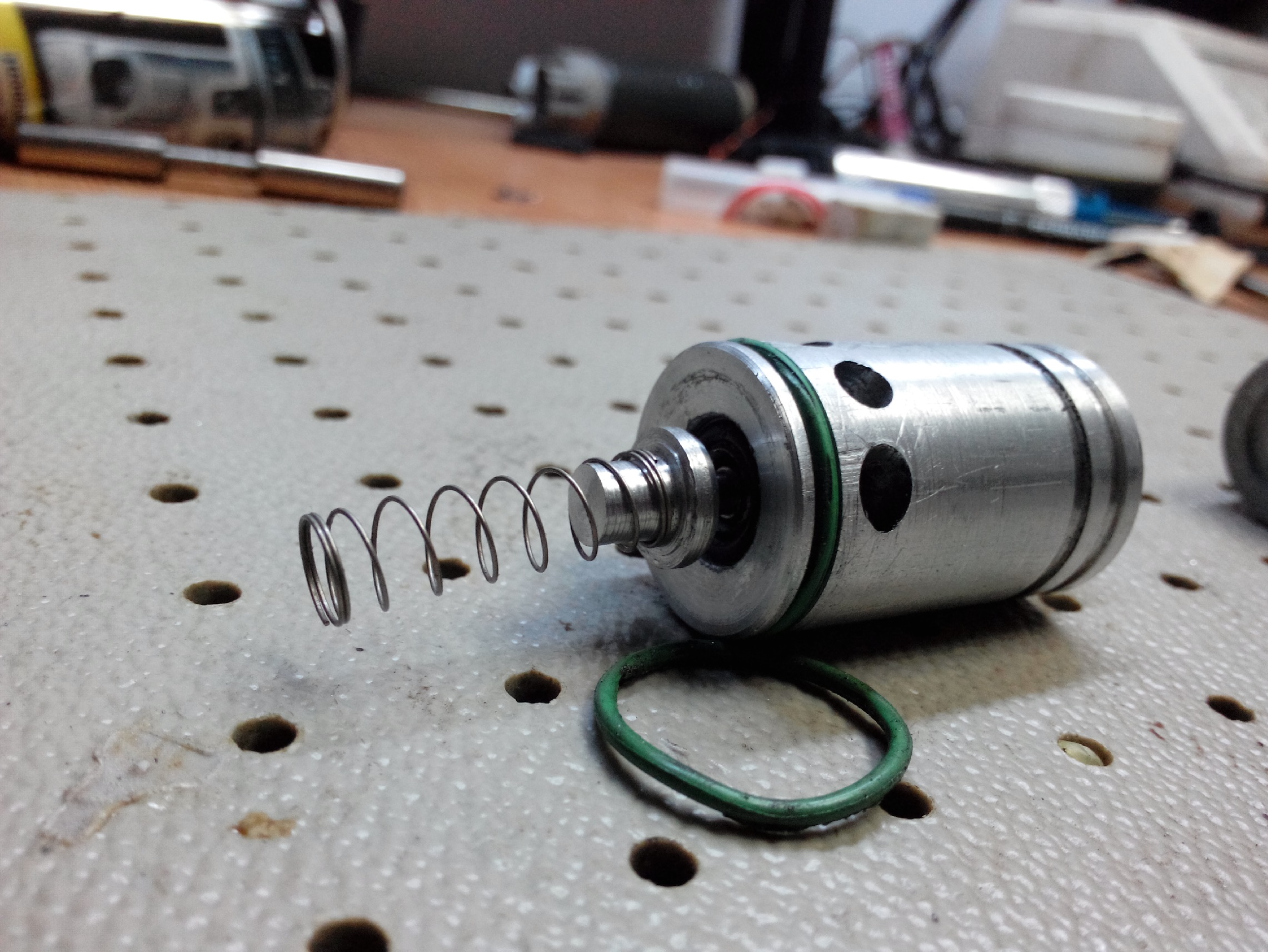

hammervalve

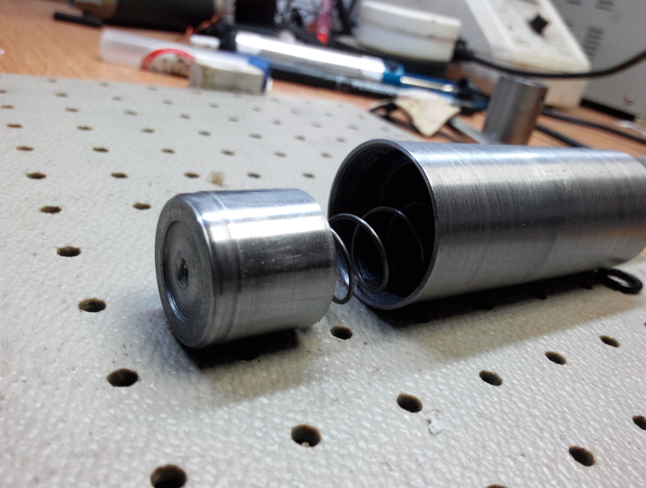

A plunger with a spring behind it could cock the mechanism.
As pressure increases in the chamber, the plunger ( like in a bike-pump) will be forced back while it cocks the hammer.
As you fire, pressure will drop and the plunger is forced back by the spring so it picks up the hammer again.
This should work with a small diameter plunger.

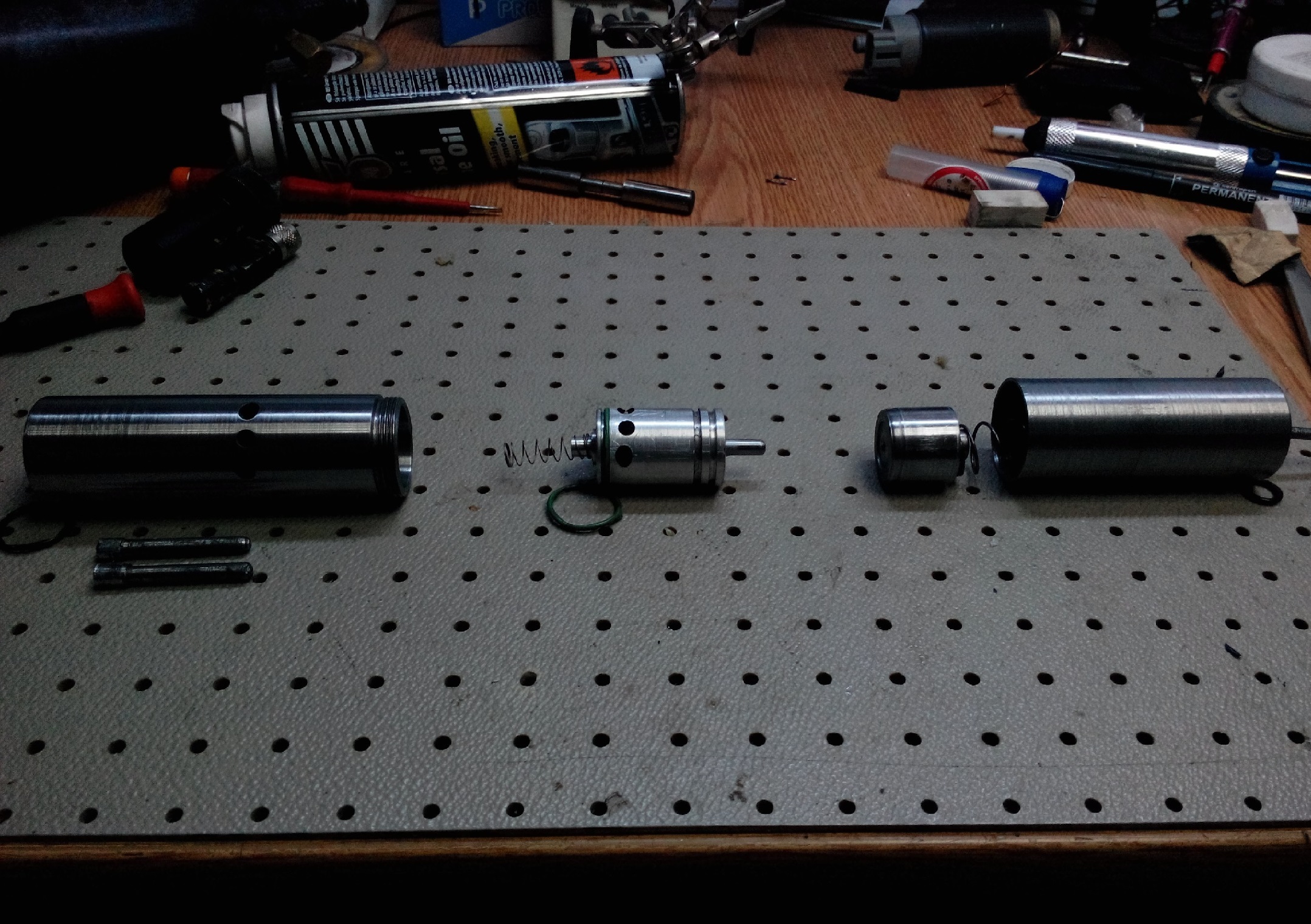

Some damage shots:

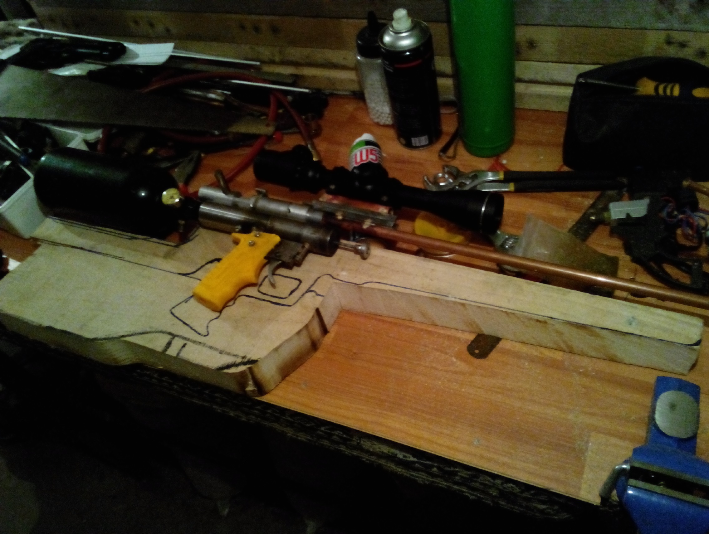

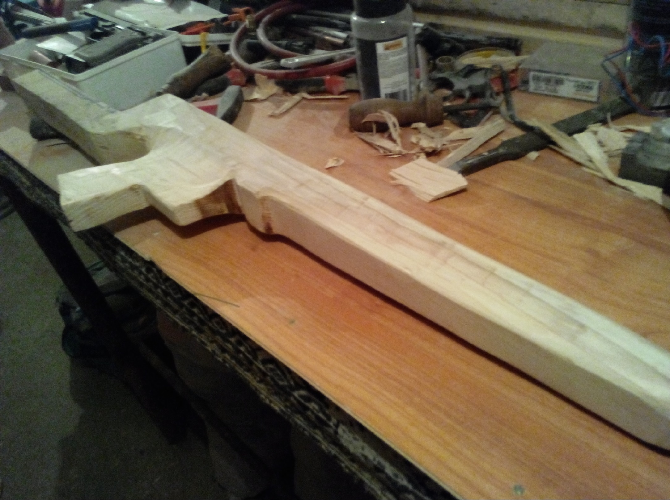

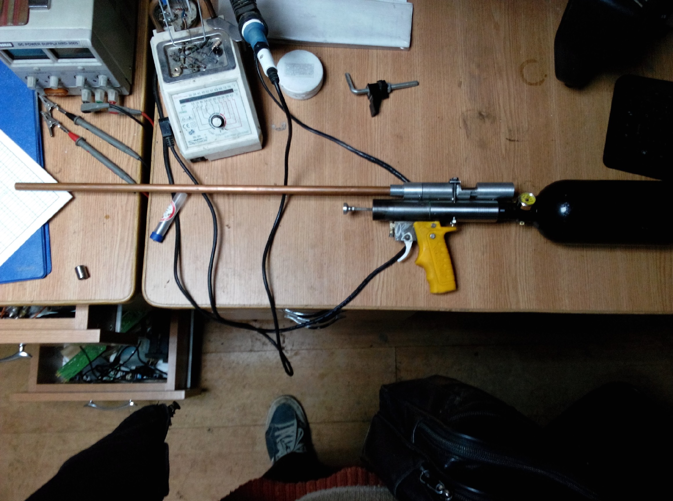

my latest work :oops:
I had to put that handle because it was hard to pull the trigger without one.
Definitely not the final look, my scope has to arrive on Monday, and I need to make a risen rail for the scope. And of course some king o stock ... haven't decided on the model.

Again "Brian the brain" make a drawing please
A simple piston connected to the chamber.
When the chamber is full, the piston moves the bolt one way, when the chamber is empty, the spring will push the piston in the other direction.
You can use this to auto-load without losing performance.

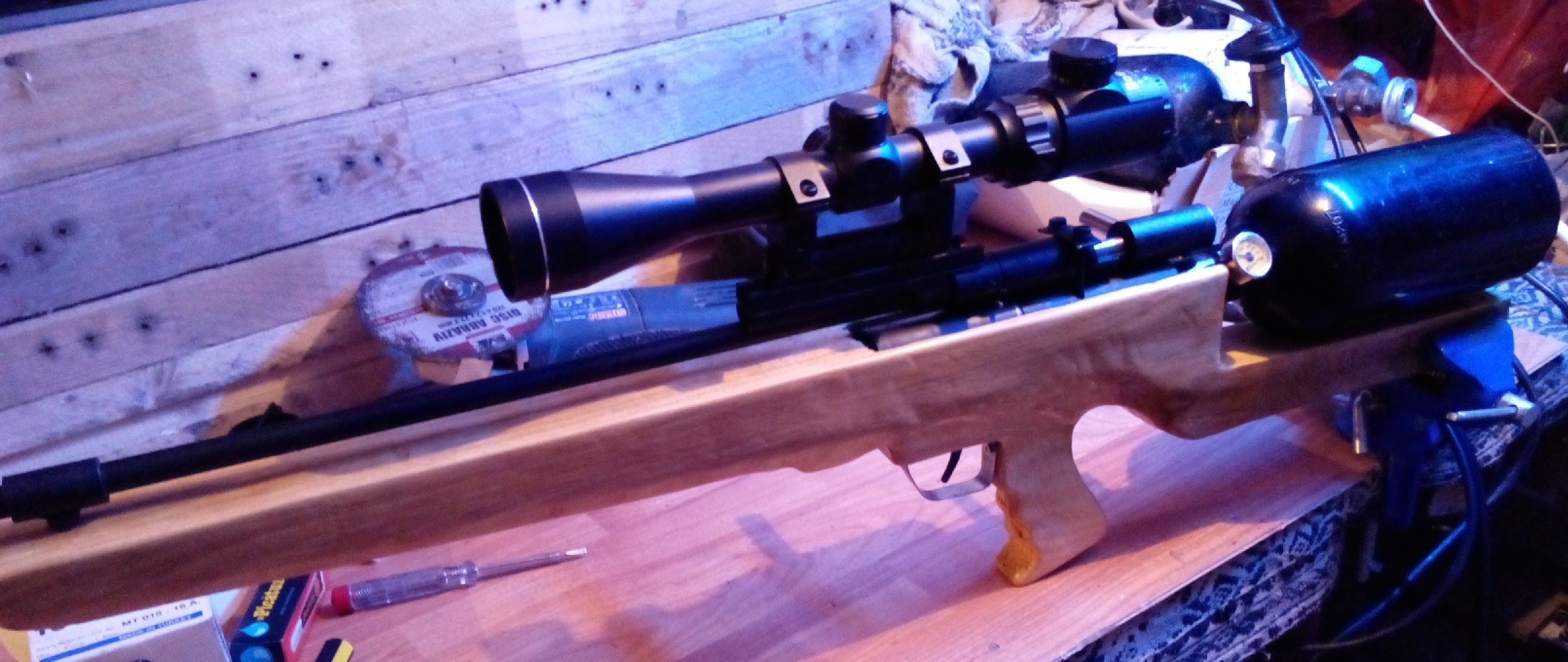

my latest work ... and the new scope

with stock assembled
Looking good, some great PCP builds happening on the forum right now :)

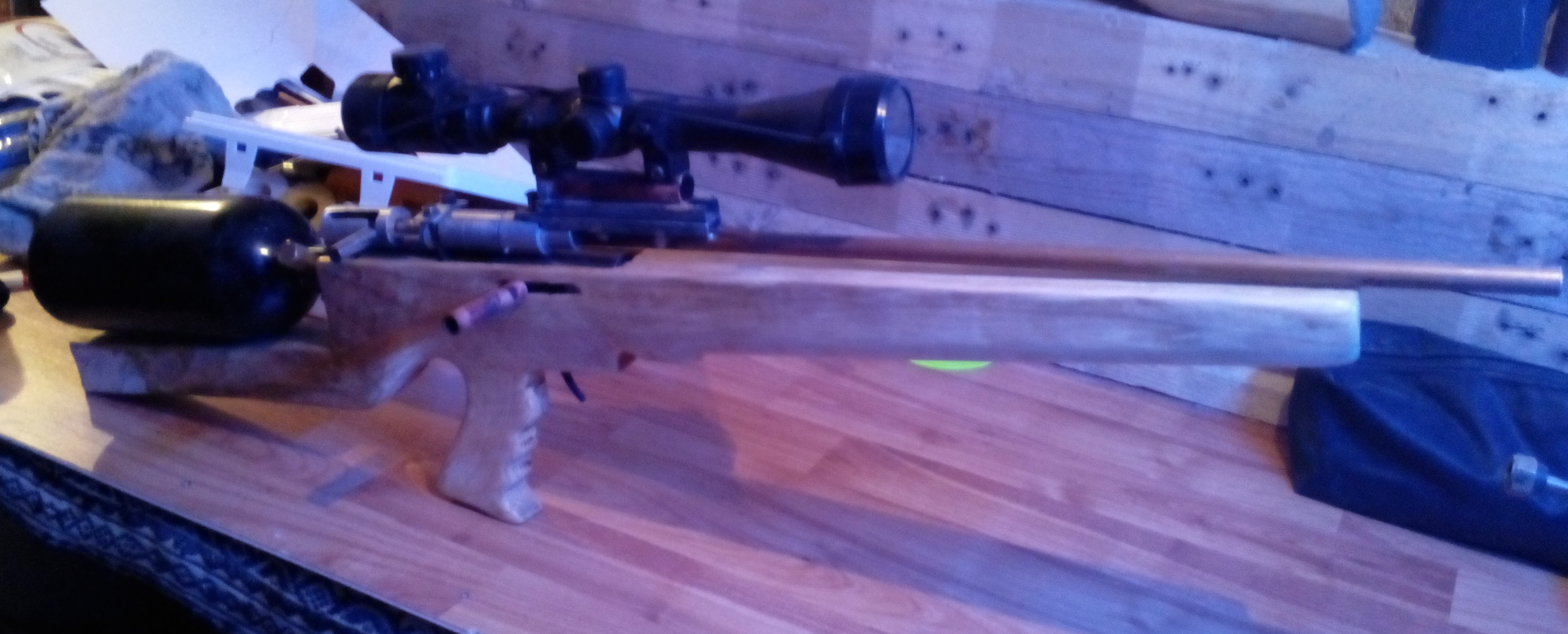

almost done
