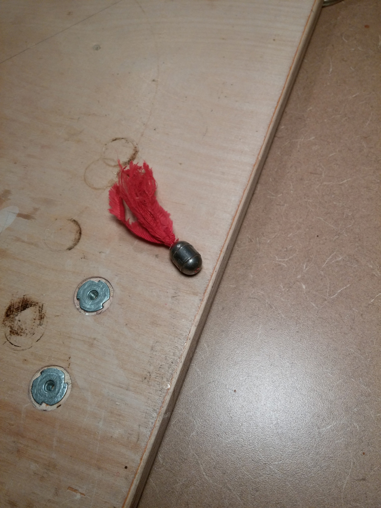

Nice hole punch
How did you make that bullet?

						Looks like a lead fishing sinker that he tied the streamers to. Just can't see the little brass eye you tie your line to because of the angle.Gun Freak wrote:Nice hole punch

Thanks all! The slug is an Eagle Claw brand steel egg sinker. This sized sinker fits perfectly in the 1/2" copper barrel. Added the red ribbon to find it in the grass when I was seeing how far it would travel across a soccer field
. I'm going to add a simple sliding breech load to it by cutting a hole under that short piece of copper repair coupling.
