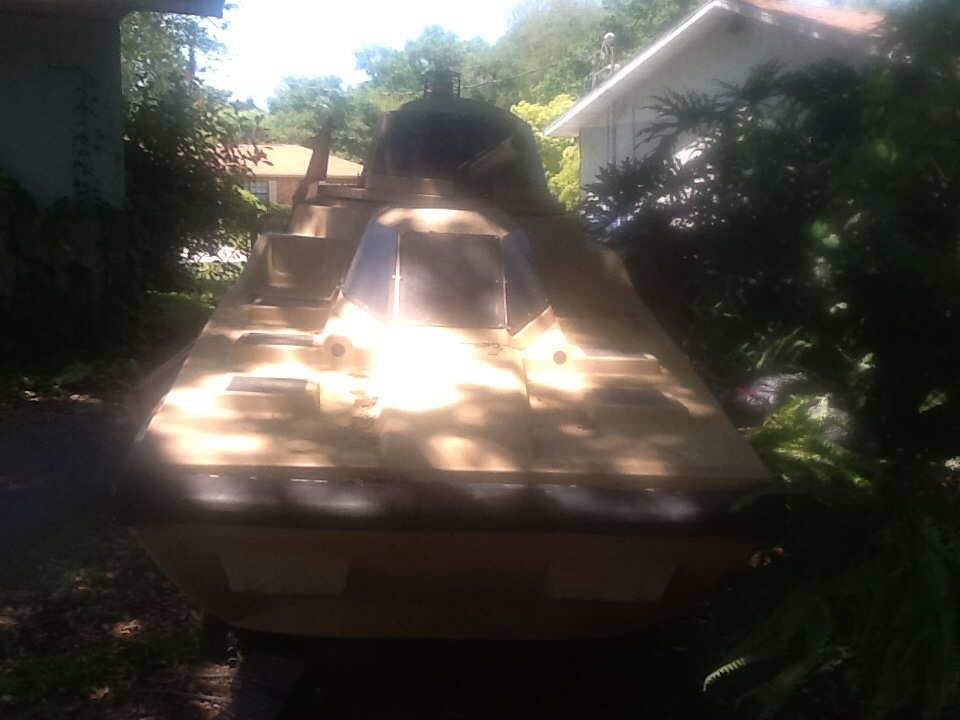

It's actually powered by a Honda zero turn radius mower engine with some crazy hydraulic drive system. I was about to step outside and take pictures but it started pouring. That's okay, I can wait ten minutes and take some more.
Thanks for the welcome. I think I can easily place a vortex gun in the turret, I'm just limited by room, and I'd like to be able to cram a larger than average amount of BBs in there, right next to the main gun. There is room to put a large-ish tank (maybe a scuba tank if I can find one cheap enough) as an air source for the vortex gun, but I'd like to use something smaller. The main gun actually has an air compressor fed by the engine, and an electrical switch that allows for the circuit to complete and the gun to fire. That part is pretty awesome, I just think right now with it I have some kind of plumbing issue. There seems to be a blockage in the lines.
I have some old pictures here that show the general appearance:

Well, seeing as it's at the GF's parents' place right now, I'll send some of what I got, and get you updated ones the next time I'm out there.
Couple different angles of the main gun. Gonna have to find my engine pictures later.
